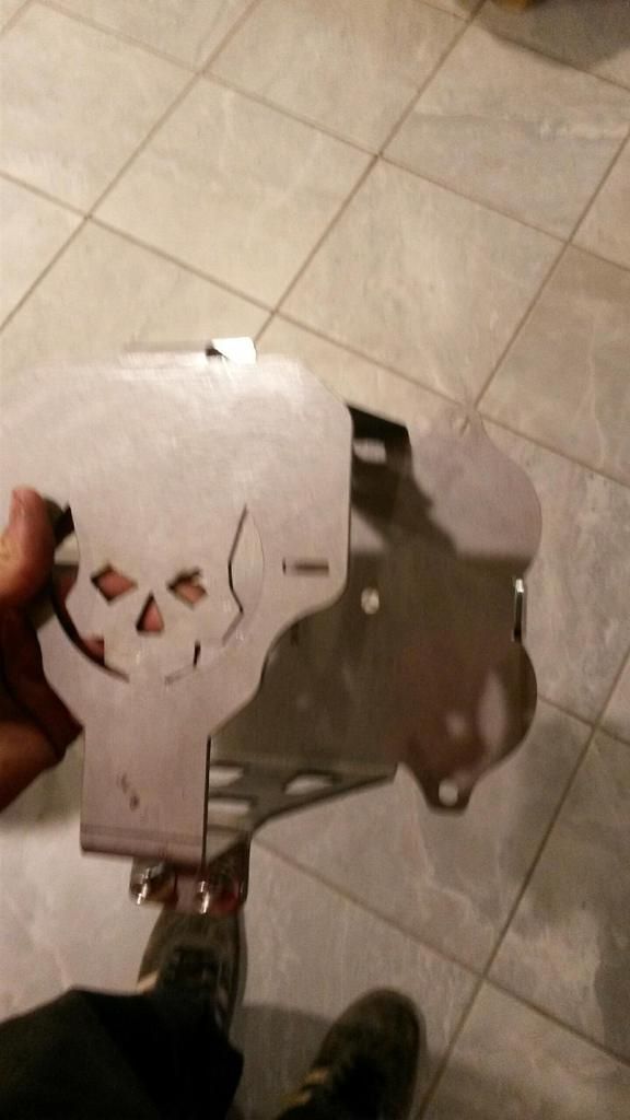

still waiting on a warm day to paint this thing... we got 12" of snow yesterday so today I kept up my theme of little stupid projects and built a cover/trunk/place to keep my spare tire, and made a start on a skid plate
1x1 square tube frame and an 1/8" sheet broke 1" on either side.... gotta pick up a piano hinge and latch so it locks to the tailgate. I guess its kind of a tonneau cover, i know....lame
3
heres the bottom of the little cover before i cut the other two braces and welded it up
