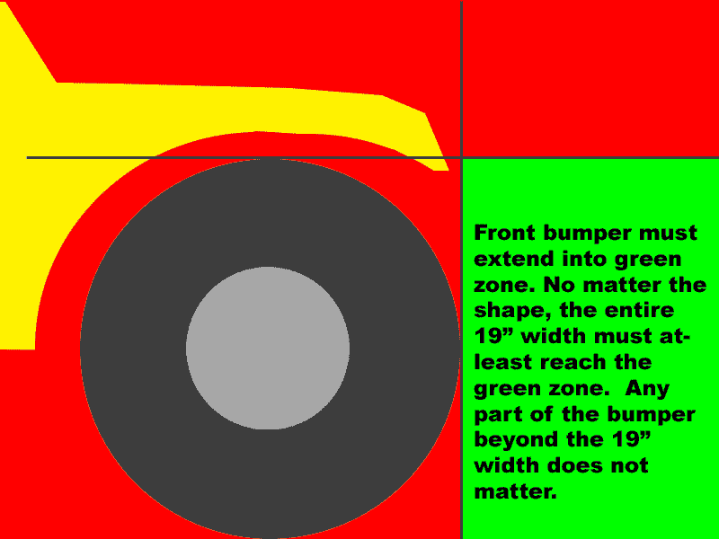

Lil,
how's this?
W.E.ROCK will have a 37" tall temporary wall set up for tech. Each team will be required to drive up to it. If the tire touches the wall before the bumper, it's obvious you are illegal. If the bumper/stinger/or other part of the vehilce touches first, measurements will be taken from the wall to the tires and that distance used as a reference for measuring whether the entire 19" width of the bumper is legal. Outside of that 19" does not matter.
What about something like this?
Then possibly a downward view of the same diagram, using the green box?
The major difference in the rule is just requiring a "Front Bumper" and not letting the frame rails be counted as a bumper if there is no bumper.

Anything sticking out beyond the front bumper should be considered a stinger or frame extension. The problem we got into years ago was Becca had a crossmember that was at the proper distance for a legal bumper, but because it was not at the end of the framrail, it was not considered a bumper...it should have been because we had a tube running between rails at the legal distance of a bumper. Her crawler was the exact same as the diagram of the current ruling's more than OK you have shown above. As BR didn't want to re-define the bumper/frame terminology he deleted the bumper altogether after I explained over and over and over that what he was defining as a crossmember was really our bumper...the extensions further outward were simply a steering box mount. If we had to put a bumper on that, it would have put us and a few other teams at a huge disadvantage due to the way they were changing the rules.
Really, the way to make this fair is to define any tube connecting the left and right framerails, that is forward of the front tires, can be called the bumper, as long as it fits within the definitions of the bumper rules. Equally, it needs to be enforced that way.

I agree as well. What is the reactions of the comp only area?
Most of the guys agree to leave it alone and just clarify with a diagram.
They also want to know where you come up with the 8.5" from the centerline and how you get 19".
9.5" is the correct deal. 16+1.5+1.5=19/2=9.5
and it would be 8.0 from the inside of the frame rails
