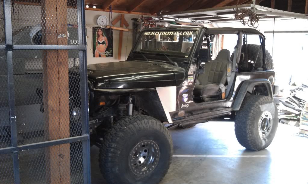

Started this Jeep adventure like most. Bought a stock 97 TJ and went shopping. 5.5 Rock Krawler kit and 35's. Bunch of mods later and moved up to 37's. Then came Ultra4 WTF.... I want to go fast. three years forward, The weekend after my first Rubicon trip I desided to build it bigger and better. :D
Made room in the shop

Shave kit requires you to turn down to 10.050" so about 7/16th. It took a while to do cuz I was a fraid of getting the ring gear to hot.
Still working on the cage a few hours durning the week and weekends. So far I've burned through 4 sticks of material 96' just ordered 3 more.
Bendtech kicks ass. all I can say

For the price and style you can beat it. Got both of them onsale. Saved a few hundred bucks with the pirate discount.
I heated up the axle tube first before welding. Front was a bitch to get right, It wasn't made to fit the Dana 70 4" axle tube. So I had to modify the front skid.
The rear 14 bolt fit perfect.
The Dual 4-link Bracket (pair) looks to be the similar to the Genright bracket.
