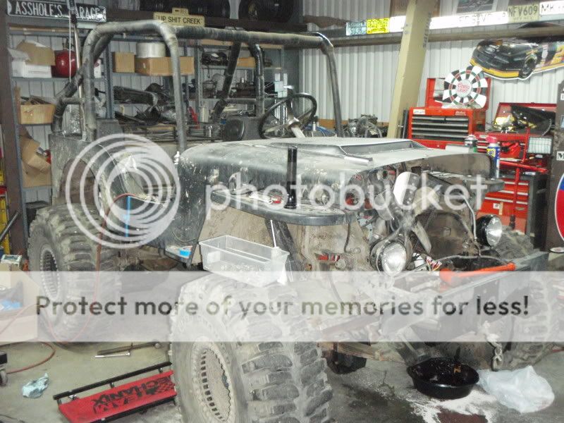

After my last trip to Fordyce I was pissed about nearly rolling back into the river coming out of Committee. If that tree hadn’t broken my flatty’s backward tumble, and subsequently dented the corner of the tub, I might have been in deep shit.
I had one more semester of partying like a rockstar left, so in between whiskey cokes, Keystone Light, floating the river, riots and the occasional class; I plotted how I was going to make my GPW into exactly what I wanted.
After much Jeep and Gen4x4 pages regarding frame design, and conning a few mechanical engineers I know into running my design through solid works, I had a working idea. I would have had a job, but the damned economy went into the shitter. While looking for a job, I decided to build my 1945 GPW and fix a few things that had bugged the shit out of me for a few years.
This is what I started with, note the stock Samurai for comparison:
The Jeep Stuck on WH1:
Frame flex demonstrated going down WH 3:
I was done with this so I decided to rip this fawker apart.

Now for the cutting:
Boxing every bend in the frame. It adds significant amounts of strength vs. weight as it keeps the tube from crushing under a bending load:
Frame coming together:
Frame Bend gusseted on top and bottom with .250 plate:

Now for the part that makes any GPW restorer cringe: cutting the old body in half.
I marked where I would make my incision
The floor was already hacked to shit so cutting it out wasn't too big of a deal
Time for cutting:
It's sliced in half!
Utilizing the tractor to stick on its new frame:
The Jeep is now a bit longer. Now to size it up for body mounts, and possibly a floor.

Starting the body stretch, 8" in the doors, and 18" behind the door opening.

After moving the seat to a location where someone other than an Oompa Loompa could drive my Jeep, I discovered my wheel was too far from my seat. Damn.
I figured I should put more racecar parts on this, so it was time to modify this:
Added another hoop to the cage:

I then built a spare tire carrier that can support the vehicle's weight. I was tired of worriying about someone bumping me and smashing the tub. This is bolted through the bumper which is sleeved, and then bolted to the back of the cage for added strength. All is .250" wall.

The GPW completed:
