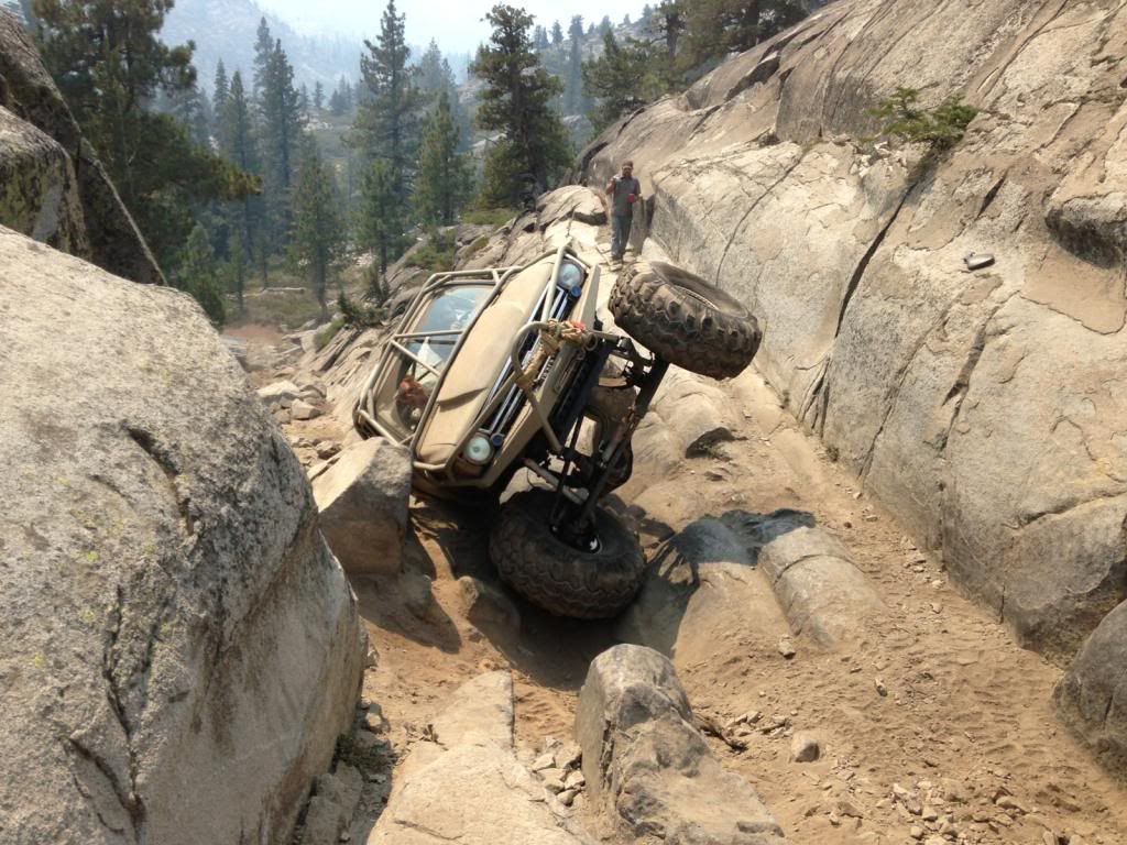

After years of wheeling Toyotas and being paranoid of breaking longfield outputs, my friends talked me into building a buggy. A local kid ponied up and bought my old rig, and I lined up a project that was just started. here is the last rig.
my little man on the rubicon a few months back
I wheeled the shit out of it, and it served me well, but its time for more power:smokin: I loaded it onto my trailer along with a boat load of parts and drug it home:eek::eek::eek::eek:
ok not really, i just used the toyota to back it into the shop.
