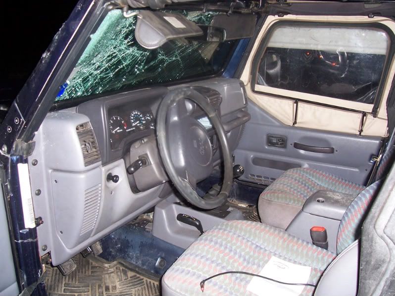

Interesting, pitman arm sheered off at the steering box? . What are the plans? It's hard to tell from the pics, but the tub looks like it's tweaked, what about the frame?

Made the road trip to TX to pick it up. Here is once I got it home.
Hold your breath. I'm about to show ya
:D
I bought it off a kid in TX that had it for 1 mo. He was in the service and saved his $ for a jeep when he got back home. He ran out and paid cash for it and didn't have full coverage. He was on his way to work going into Dallas when the pitman arm sheered right off the steering box. He went into the concrete median at 70 MPH. The jeep went over the median and into trafic on the other side where people were doing 70 at him. He slid across 3 lanes of trafic to a stop on the side of the road. The dude lived. I wanted something that was a total piece of $hit so when I got done I would realy have something to show all the work. But I didn't know it was this bad until I had already hauled my jeep there for the trade. No turning back now:D
