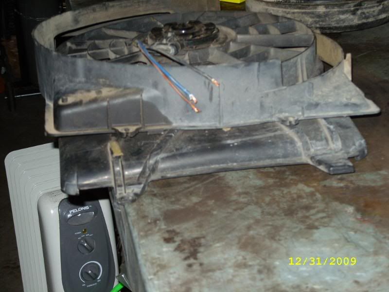

Update that i had forgotten about.
i wanted to run a taurus 2 speed fan but was to lazy and cheap to buy a radiator or have a shroud built so what i did was install the tausur fan into a stock toyota shroud cheap and easy :D
the mock up
you can see in this one where i had to cut the taurus shourd
fast forward i'm sure you get the idea on cutting to the finished product
and another
in this pic you can see how i just drilled and bolted the two shrouds together :D
and bolted in. it was tight because i have a gay body lift but i flipped the shroud over and fits perfect
