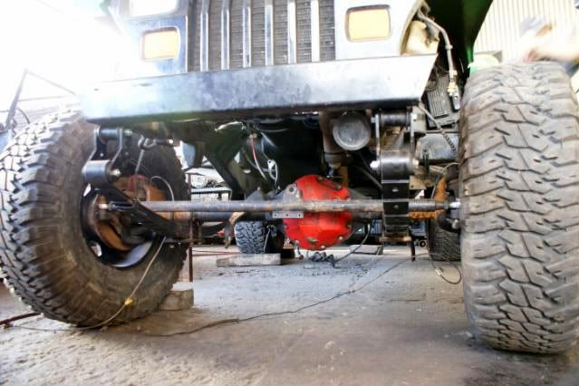

On this Jeep, I decided to go with Waggy springs all around to push the wheelbase an extra 5" or so. I'm running a 8.8 rear with chromo axles and a Detriot locker and a Dana 44 from an early Bronco up front, also locked, with chromo shafts. The tires are 37 Goodyear MT/r and I have a hydro assist. setup to help turning.
I'm installing a 4-1 t-case from a Rubicon and clocking it to help fit a flat belly skid plate. I'm leaving the motor stock and adding a low stall converter to the transmission along with a big B&M cooler. We installed a 1" body lift and the MORE 1" motor mounts to help line everything up.
We did a mock up of the SOA to see how it all fit...
My first thoughts were "Man that's tall, and the tires look small" the frame is 27" off the deck.
Then I started planning for all the things I needed to deal with the height and the SOA configuration: Antiwrap bar for the rear, Antirock for the front, firm shocks with a ton of rebound dampening to controll body roll etc... one of the things I hated about the Explorer was how tall it was and how hard it was to control that tippy, body roll feeling. I started looking into things to lower it down a bit, frenching the hangers, going to some flatter springs (but I'd lose the wheelbase)
After all that, I said "let's try it spring under see how it looks. I got a Rock Crawler hood from a friend so I don't have to worry about clearance up front and hopefully I can skip the antiwrap bar for the back. Now I just need to open up the rear fender wells as much as possible, find a way to install the inner fenders up front, find some u-bolt flip kits to clean up the springs, and see how it works!
I'll post more pictures as we make some more progress and let you know how it works down low... Frame is a little over 21" off the ground.

The springs are front Grand Wagoneer springs. I used them for the offset pin that allows me to stretch the wheelbase a few inches front and rear.
I still have the antiwrap bar, I needed to cut the axle mount off cause it hit the gas tank when we lowered the jeep (top of the mount leaned back too far). If I need it, I can re-do the mount and be good to go!
I just ordered the B&M shifter that's going on the floor and I'll be tapping the steering box soon so we can get the hydro assist. system set up...
Anybody have some ideas on filling the inner fenders up front? I'm going to try cutting off the old inner fenders and installing them with something to fill the gap up top...

I had a set of TJ flares to use when it was SOA, but now with it dropped down: I need to cut a lot more. The first pic shows where I'm going to cut (yellow line), then I'm going to bump stop it to keep the tires from rubbing. If it's too limiting on the uptravel, I'll cut out the tubs and raise them up a few inches. The red line shows more or less where I was going to trim for the TJ flares (yeah, I got mad MS Paint skills:flipoff2: )
I'm going to have a friend make me a set of tube flares like the GenRight ones once I get everything worked out back there... (like the ones in the 2nd pic)
