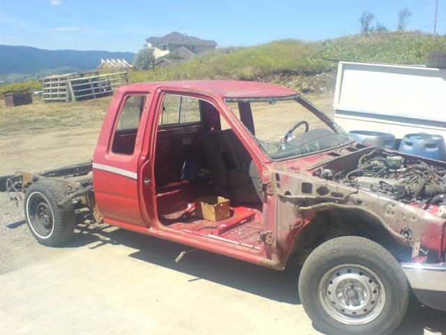

this is how i bought it rolled and 2wd (not for long)

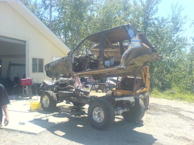

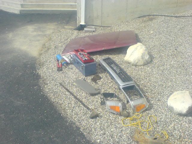

getting her striped
the donner of rear axle and many many random parts

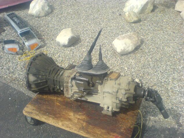

got some parts from pick and pull (and w56 with gear tranfer case from a 4cyl 4runner)

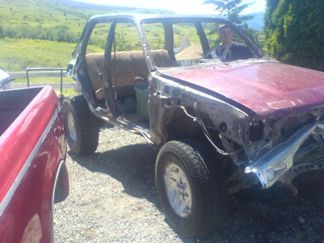

stripping the beatup 4runner with 3.0l
