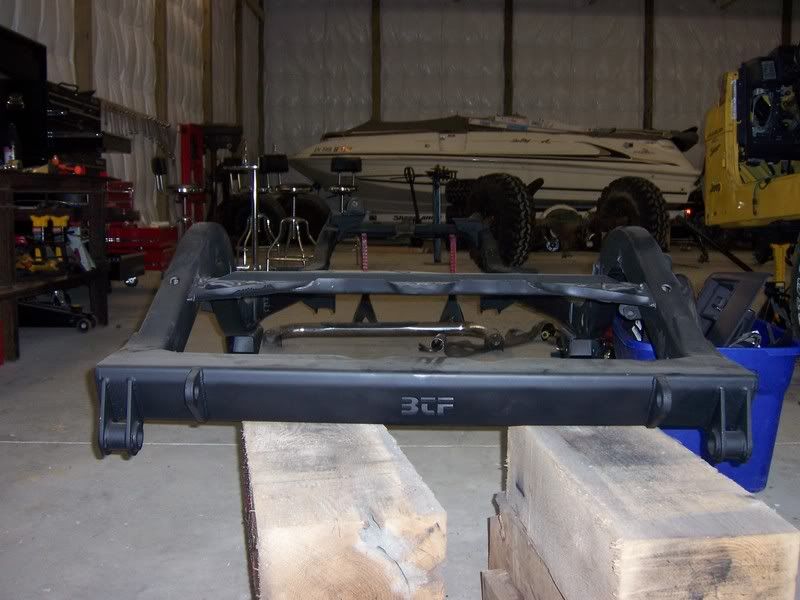

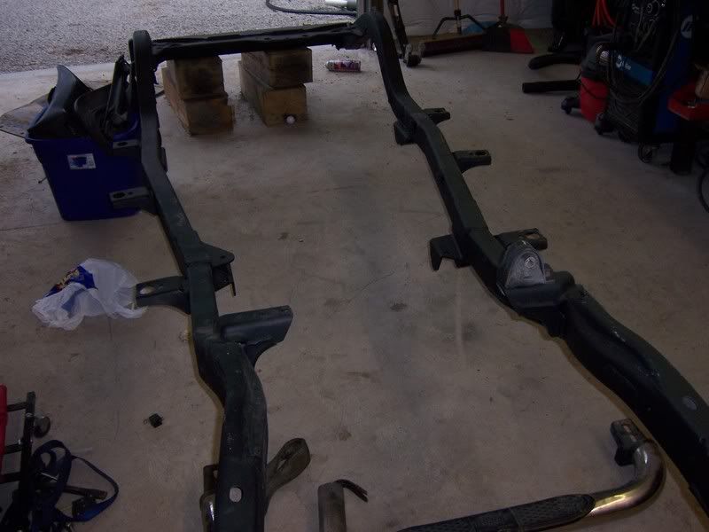

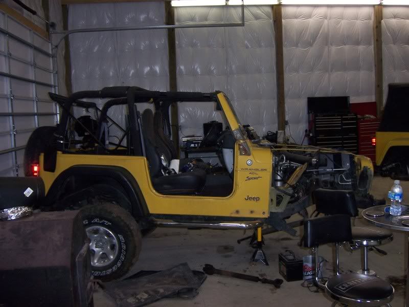

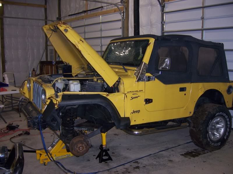

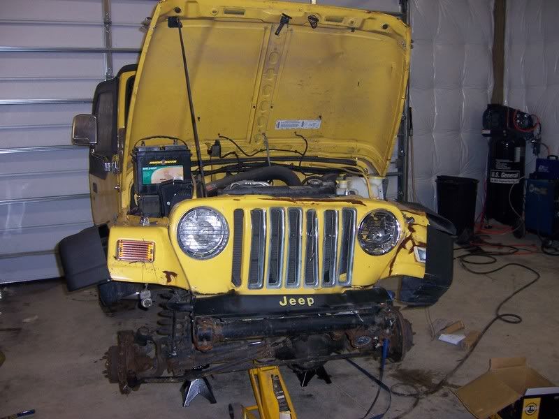

I have been working on this project for about 6 months. I knew it would start slow so I waited a while to post; but I need to stay motivated and I know you impatient bastards will help me with that! Now on with the pics. I started with this piece of shit!
I dont know the story behind the jeep but it came to me with a custom bent frame, blown airbags, twisted dash and a twisted tub..

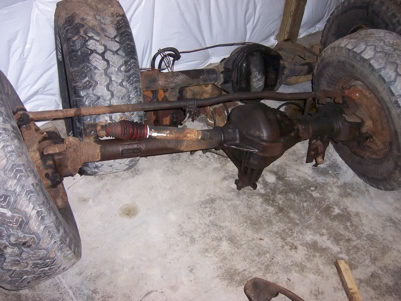

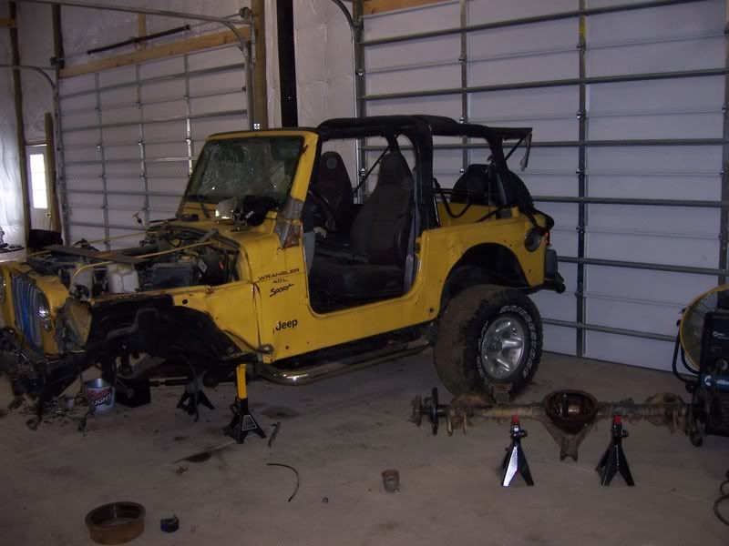

I then purchased a new, to me, frame $200 and this snowfighter for $1000
I added the BTF rear stretch bumper, frame brackets for the rear xjs and front three link were purchased from poly perf
just cut out the axles on the trailer and scrapped the truck, in the end I got my front 60 for around $700

I see 2 yellow Jeeps. The other one looks like it has a reservoir shock, at the least.
Please explain.
There are two yellow jeeps the other is a mildly built tj ,longarm, 44's front and rear, 37 inch rubber and yes just resevoir shocks of the eldebrock flavor

Here are a few pics of how the project has come along in the past few weeks. Sorry for the huge gap in pics, but I will go into further detail as I fine tune specific areas of the build.
Currently the jeep is sitting at 110" wheelbase using xj springs in the rear and a poly perf 3 links and 14" coil overs in the front (the rocker currently sits at 30"). I am running the 78 ford 60 in the front with an Eaton in the rear on 39.5" rubber. I am sticking with the 4.o for now but I do have a garret turbo and split second mapping system to liven the ole girl up a bit. I also have the stak 3 speed installed with flat skid after a lot of hacking. gears and lockers are still up in the air 4.56, which is what the Eaton is equipped with, or 5.13s are the two ratios im debating over (any opinions would be appreciated). Steering power will most likely be provided via double ended ram setup
