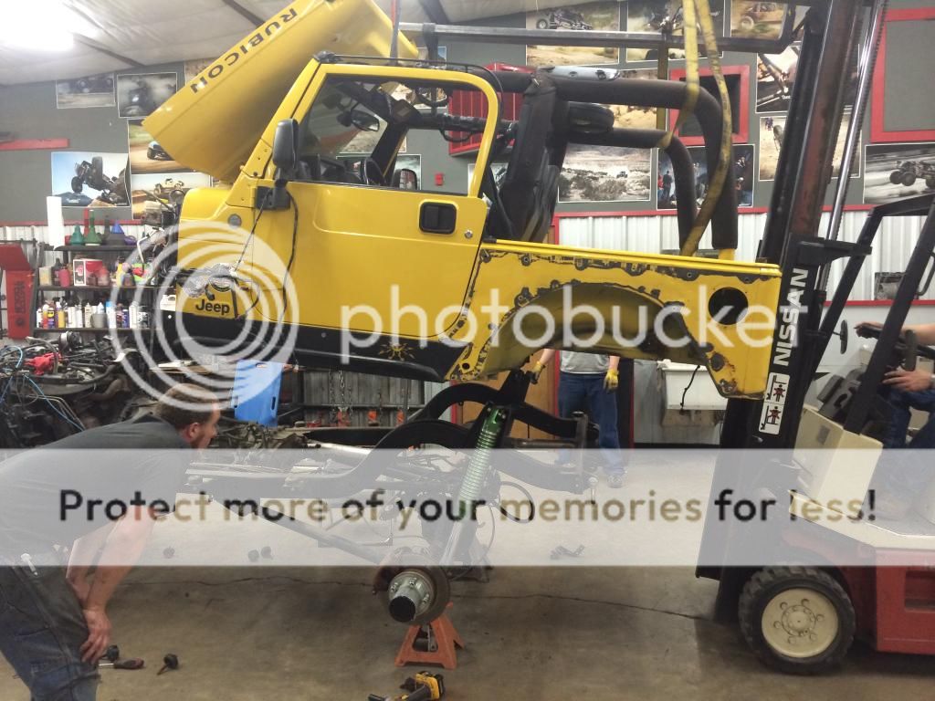

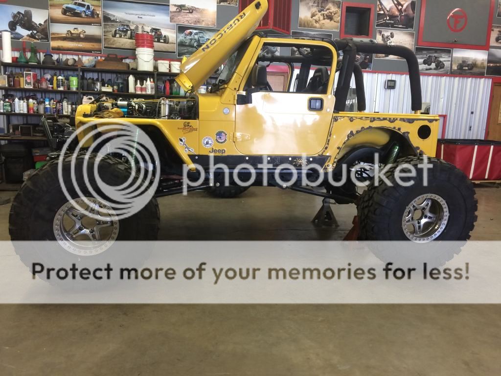

Guys continue to make progress at the shop. My back is finally starting to feel better. Can actually tie my shoes now...
Back half cut off
BTF rear frame kit welded in
Body on. I left about half of the bumper hanging out from behind the tub.

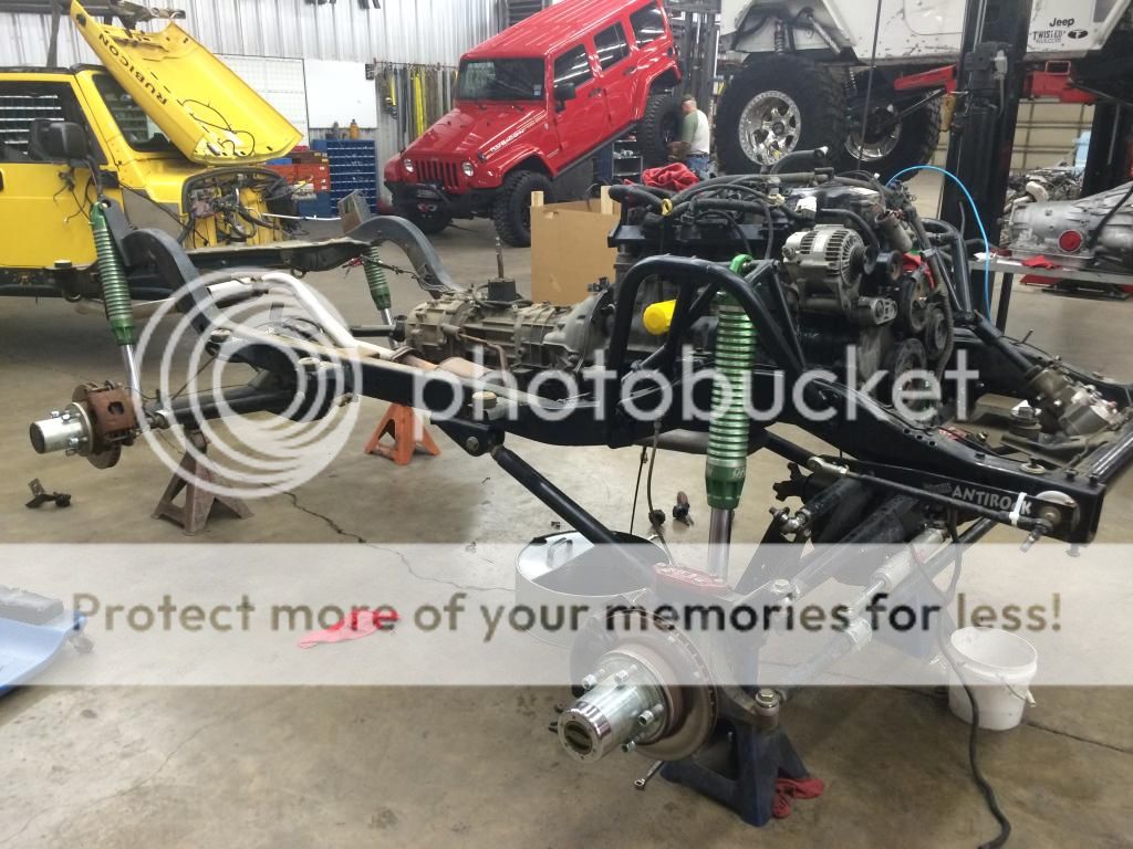

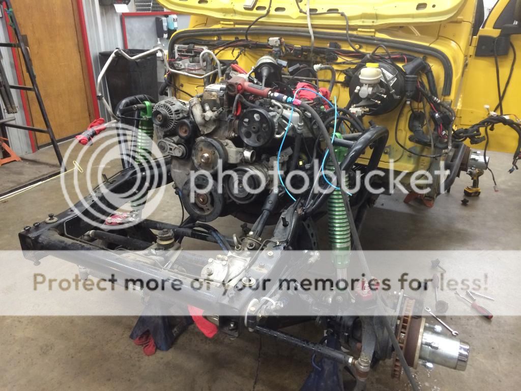

Got the motor pretty well set. Need to look at exhaust routes, control arm brackets, link clearances, etc. Will work on engine mounts and trans/tcase crossmember tomorrow. Trying to get a flat belly without too much tub work.

rear axle location
front axle location
belly clearance with 4L80E and Atlas

A bit frustrated with Poison Spyder. rear corners are off
and front highline fenders are bowed. waiting on Poison Spyder to resolve.
passenger is off 1/2"
driver is off 7/8"
