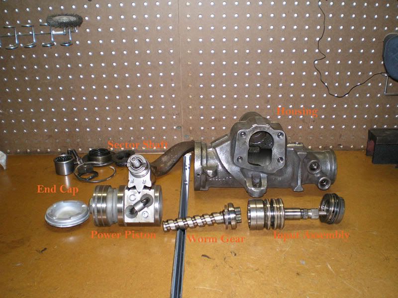

The particular model I will be rebuilding is a “Model 83”- as noted by the raised numbers that can be found in the forged housing. I am unsure of all of the available years that Chevrolet used this box; however, I believe they were on every ½ ton from 88-98. The larger tonnage (3/4 ton and 1 ton) used a heavier duty box – Model 84 – that consisted of a larger housing and larger internals; the premise is the same though.

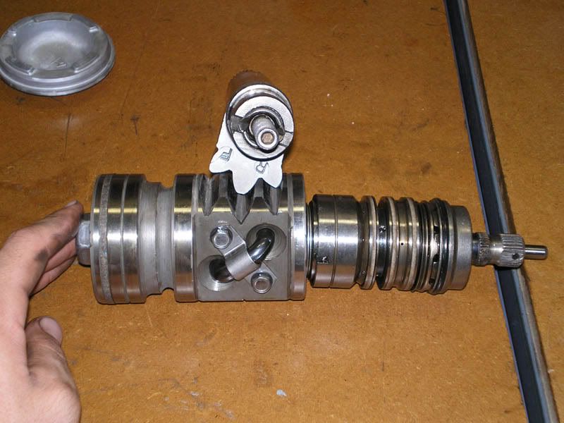

Here are all the internal components of a power steering box. From left to right: end cap, power piston with sector shaft sitting on top, worm gear, and input assembly. The box is in its proper orientation (meaning the things in the left of the picture fit into the left side of the box etc).
These are the two locations for tapping a steering box. Look at Billavista’s article in the Tech department for more information.
The internal components fit together in such a manner that they operate as one unit. Here is how once inside the box, everything will look.
*Note that between the base of the worm gear and the front of the power piston is a wall inside the housing. So in fact, these two surfaces will never touch – this picture is just for the effect.

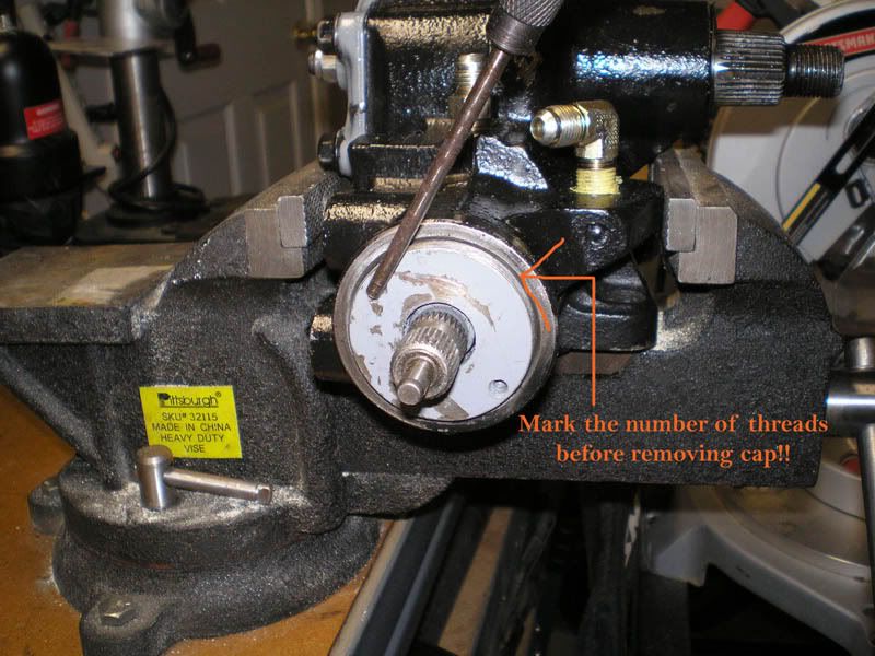

First remove the retaining collar by turning in a counter-clockwise motion. Vise-grip pliers or the like can be used, but I prefer a punch. Once loosened, it threads off very easily.

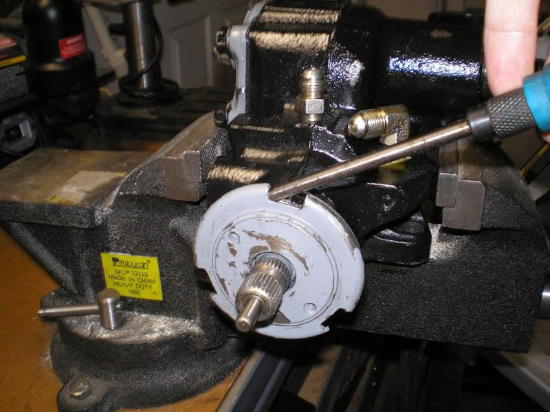

Next mark-or count- the number of threads that can be seen on the front of the input assembly plate. This will insure the proper preload is applied to the assembly, and does not require the purchase of a spanner nut to set the proper torque.
After marking the threads, remove the plate by turning counter-clockwise. The proper spanner nut makes this easy, but improvisation gets the job done as well. You can use a punch as pictured here, or an easier way is to find the proper Allen head wrench that will just fit into the hole. Align it so the force is tangential to the plate and loosen away with a hammer to the base of the long end of the wrench (sorry I did not get a picture, I thought of this method later).

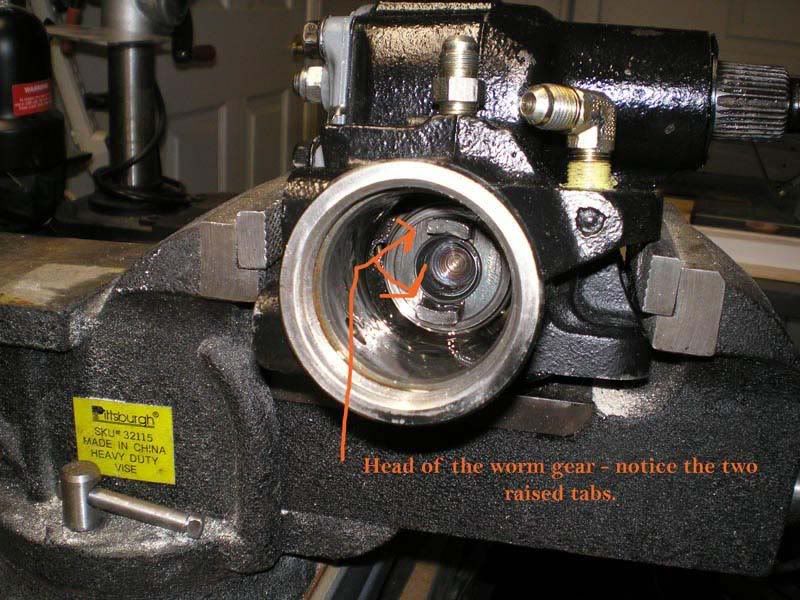

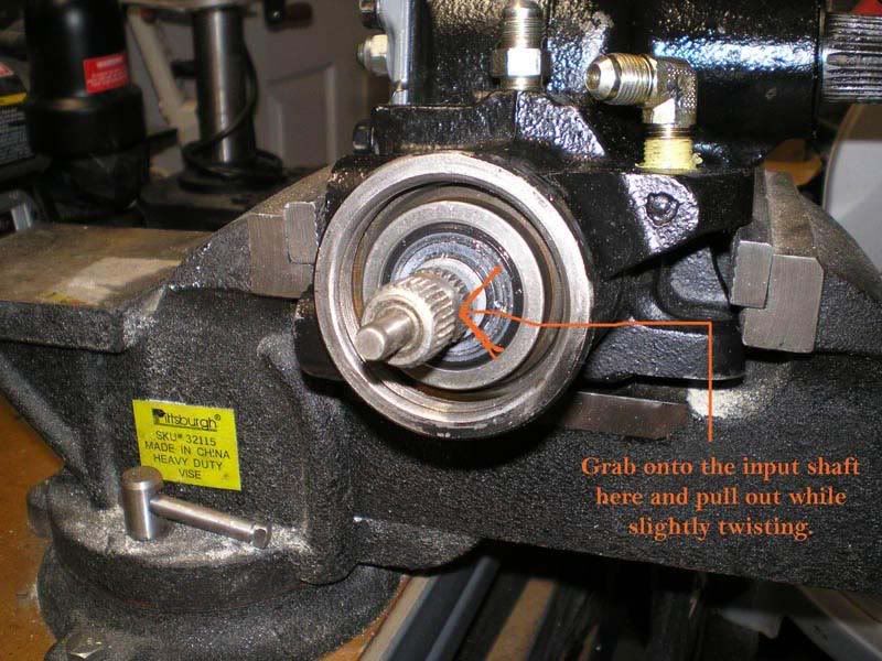

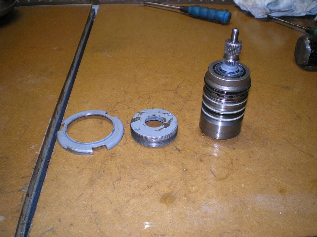

This is what you will see after removing the input plate. Now pull out on the input piece (grabbing onto the splines is the easiest way to get a hold of it) and slightly twist as you pull.
After removing the assembly, you will see the head of the worm gear in the housing.
Here are the three parts you have removed so far: the retaining collar, the input plate, and the input assembly itself.

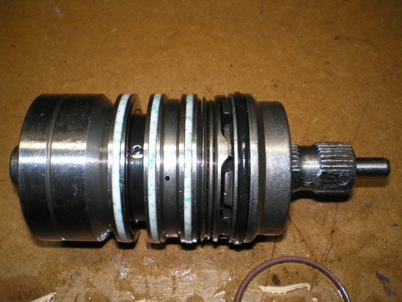

Here is a closer view of the input assembly.

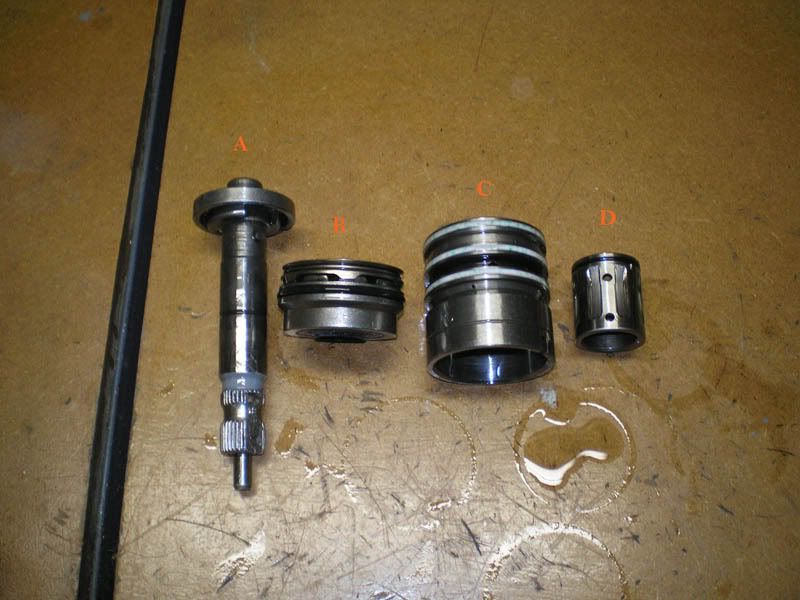

The input assembly consists of four (4) main components, some of which have seals that must be replaced in a rebuild. For simplicity sake (and because I have no idea what each part is properly called), I will name the parts as following (from left to right): Part A, B, C and D.
553 Posts
Discussion Starter #2 (Edited)
Part B simply slides off of part A by pulling towards the splines.
Here you can see the seal and o-ring that must be replaced. Some rebuild kits include a replacement bearing for the one located behind this outer seal. After removing the seal, gently press out the old bearing with a socket and hammer and replace it with the new one.
*Be careful however, as this part actually consists of 4 or more parts. Too much force trying to remove the seal can cause part B to disassemble and I did not get pictures of putting it back together. Although, don't worry it can be done.
To separate the remaining components from part C, simply push on part A (from the splined side). This will force the remaining components out the back of part C.
If part D does not come out with part A – simply put a socket onto the lip of D and hammer it out. Here you can see its location.
Part A and D fit together as shown here. Note the small nipple on part A that fits into the hole in part D for proper alignment. You can also see the o-ring at the top of part D that must be replaced.
Here is part C. You can see the three Teflon o-rings that must be replaced. Also, underneath these three o-rings are three more o-rings (brown) that must be replaced as well.
So after replacing all the o-rings and seals for the input assembly, place the components back together as follows.

Here you can see the sector shaft/power piston teeth mating after removing the top plate.
This is the removed top plate, and the gasket that must be replaced when rebuilding.
Next pull out on the sector shaft.
Here is a photo with the sector shaft removed.

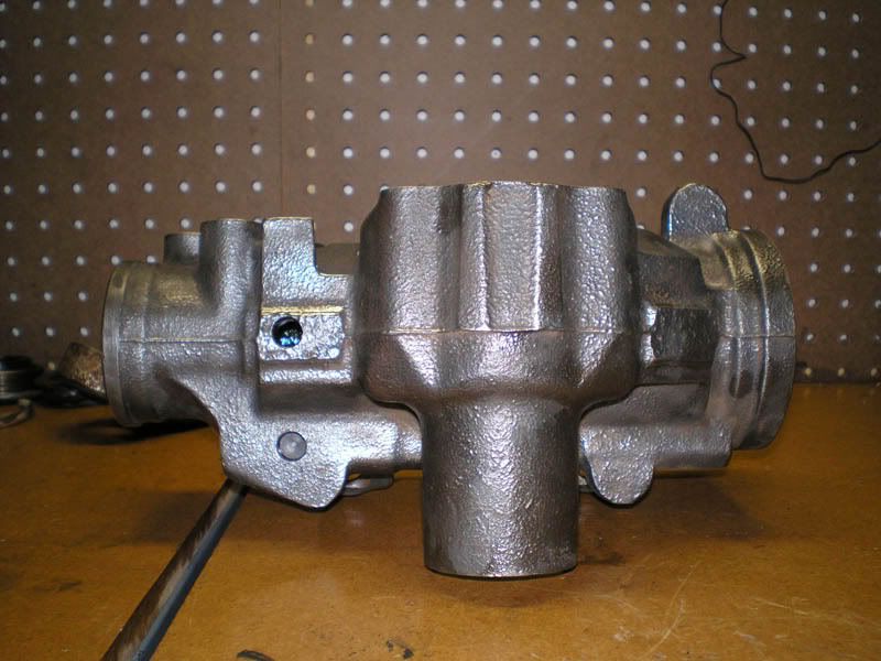

Locate the small hole at the base of the power steering box housing.
Using a small punch and a hammer beat the retaining ring slightly out of its recess.
Then, working around in a circle, use a screwdriver to pry out on the remaining ring.
Flip the box around, and locate the head of the worm gear. Grab a hold of it, and twist as you pull out. Be careful though as some of the ball bearings may fall out (this is normal,but just make sure you can catch them if you need to)! Remove the worm gear completely from the housing.
Here is what you will now see when viewing from the input side.
The second picture is with a punch inserted through the hole and into the base of the power piston.
By using a second punch onto the first, you can hit the power piston out of the backside of the housing.

Now that you have the housing completely bare, you can drill/ tap the holes as needed. Once done, clean the housing very, very thoroughly with a solvent to remove any metal contaminants from drilling. If you did tap the box, use compressed air to clean the ports that the fluid will flow through. Also, clean all of the components very well in order to determine any damage done, and to ensure trouble free running later on down the road.
Lubricate the inside of the housing liberally by smearing power steering fluid with your finger. Now you are ready for reinstallation of the internals.

The worm gear is a machined piece, with two washers and some needle bearings sandwiched between the washers all located at the gear’s base.
Inspect the bearings for damage and replace as necessary. Clean the washers and worm gear, and slightly lubricate for reinstallation.
Here you can see the input assembly and part A from earlier recessed into part C. Note the location of the two tabs machined out and how they match the head of the worm gear. Also, replace the brown seal located at the end of part A. Place the two pieces together making sure to align the tab on the side of the worm gear, with the proper hole in part C.
Here you can see how the input assembly and the worm gear fit together. Install this one piece back into the housing from the input side.
