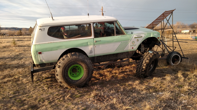

Saturday night I finished mounting the last of 'em, and on Sunday I got them all installed
They stick out about the same as the 38s did.
Much more manageable than the 44x18.50s..

So, back to the ramp.
I should've turned the hubs in - even without the tire hitting, it gets to where it shoves the ramp forward rather than climb it - I'm too lazy to drop the A-arms and make it sit in the dirt.
It cleared, though I still had another 1/4" or so of up-travel to account for.
Not much extra though.
So after I got back around to the driveway, I cut some more out for good measure.
Then a cardboard template.
I transferred it to some 18g sheet metal and got that about fitted before it was time for dinner. Maybe tomorrow evening I'll tack it into place and make another trip up the ramp - then cut the same out of the passenger side.
5,100 Posts
This time, I turned in the hubs and crept farther up the ramp.
Looks like I should've cut just a little more - but that would get into the flange for the vent. Not that the vents work, or it is a big deal - just another headache to followup with.
I see a gap in my weld, too.
This time I made it to the bump stop.
(Bump and shock fully compressed)
Much more, and I will have to worry about my brake lines - as they come out of the master.
I worked the wheel a little and listened to the tire scrub on the firewall - but "just"
So, I'm inclined to call it good enough - it lightly rubs at full bump, but a little tire wear will fix that.
I need to grind down the seam a little more, maybe tack that spot I missed, and hit it with some paint.
I'll try to get a little closer to the vent when I do the passenger side.

I suppose the other thing to ponder, since the adapted T19 would save me 4.25" that almost makes up the difference between a 2spd and 4spd case.
8,778 Posts
Tom,
I would polish the turd for now...32spline upgrade for the rear of the Dana20. That would at least "buy you time" for upgrade round two.
If you are stuck on using a manual transmission, then yes I would vote for the NV4500. I would also look at a nice used 2sp Atlas.
