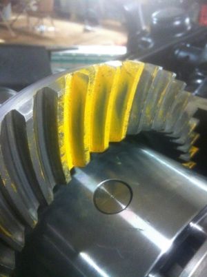

I am currently part way into my first locker install into a ford 8.8.
I have so far fitted everything and adjusted to the point which my backlash is within spec, and I have made several adjustments to pinion depth the attain a pattern as follows.
I however am having difficulty in deciding what changes are required or if this would be considered an acceptable pattern. Any info or suggestions would be greatly appreciated.

From what I see, I would just run them. Not perfect but pretty good.

the part that confuses me is the wear line closest to the top of the tooth seems fairly prominent, and not feathered, but the pattern does extend towards the root with slightly less contact.
Adjusting pinion depth to bring it in by .003 brought the pattern more prominent towards the root.

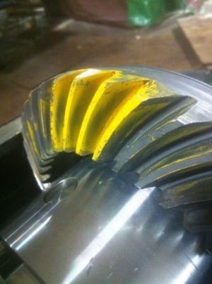

so I played around with it a bit again today, got some better carrier preload.
and managed to bring the preload down to .008
this is what I have now.
not sure if it is worth centering by increasing pinion depth and correcting for the same backlash, due to the coast side taking up most of the face.

one more time, wasnt quite satisfied with the last patten, so i dropped the pinion depth from .030 to .026 and brought the backlash in to maintain .008
I think this is about as good as I can get it.
unless anyone thinks I should be concerned with the contact pattern reaching the toe, however the contact seems to cover most of the surface.
