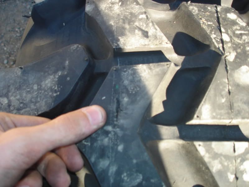

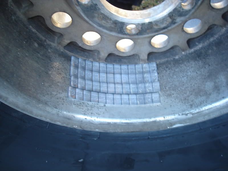

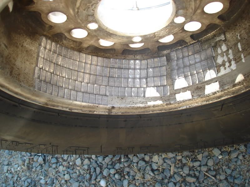

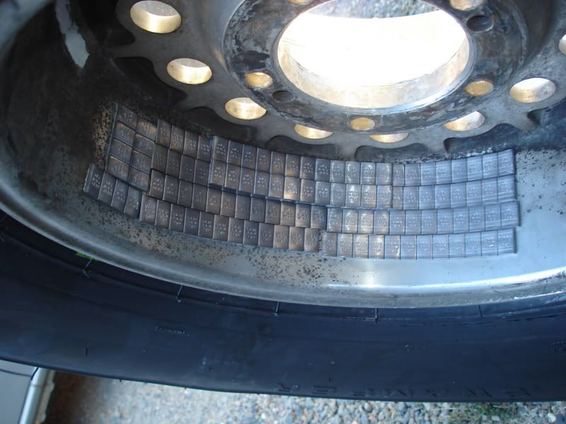

I ordered some 15-42-15 bias TSL's a few weeks ago.... They look like they were run, returned, then sold to me. Almost all of the hairs are worn off...and they took a LOT of weight to balance them. I was told by a few people that I should return them, get a second opinion,etc, so I was hoping to get some of your thoughts on them. I bought them as new, for $420 each.
What do you guys think?

Sounds about right. They are big and heavy and will require a lot of weight to balance. The proper way to balance a tire like that would to put weighted patches on the tire to get them close and then fine tune your balancing with wheel weights.
I really doubt they were mounted and ran before but even if they had who cares. Its not like your not going to run them.

pics would help of the before shot, the weight is close ( you should ditch the weights and use BBs )

They look brand new to me? Just rolling those heavy pigs around while shipping would probably knock those tits off. Balancing a tire that big will require a ton of weight.

Once you mounted them they are yours to keep... most places won't take them back if they have been mounted. They look new to me. They are big ass bias ply tires, of course they took a bunch on weight to balance. Use airsoft BB's instead of stick on weights.

How was the tire bead?
that would have told you if they had been mounted.
X8 about getting rid of the weights and using the same amount of weight in BB's

Yea, I figured they wouldn't be perfect considering they are 42's and bias. I just wanted some opinions as I am rather new to tire-buying. I don't know about the tire bead, they mounted and balanced them before I picked them up. I then took them home in the mini-van and mounted them on my truck.
They were the only shop that would order/mount that big of a tire, so I guess I will just be happy that I even got them. I don't mind if they were blems, or returns but I don't like being lied to/tricked into buying them as New.
