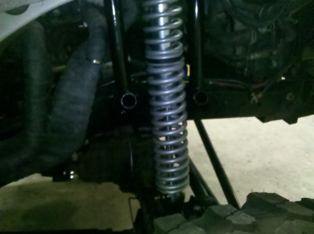

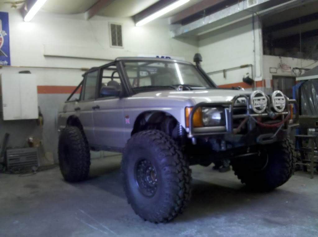

Finally got the front coilovers mounted on Friday. It is a little tall in front, but I have the adjusters threaded down so the coils won't unseat at full droop. I have 6" tender coils and sliders coming so I will be able to drop the front down 3" - 4" to make it sit level.
I still have to fab the cross-bar between the hoops and mount the rad resevoir, the steering fluid resevoir, and a few other bits under the hood that had to be moved to make room for the hoops.
Plus, I'll have to make some cuts in the hood for the hoops to poke through. But hey, everytime I remove sheet-metal, it gets a little lighter!:grinpimp:

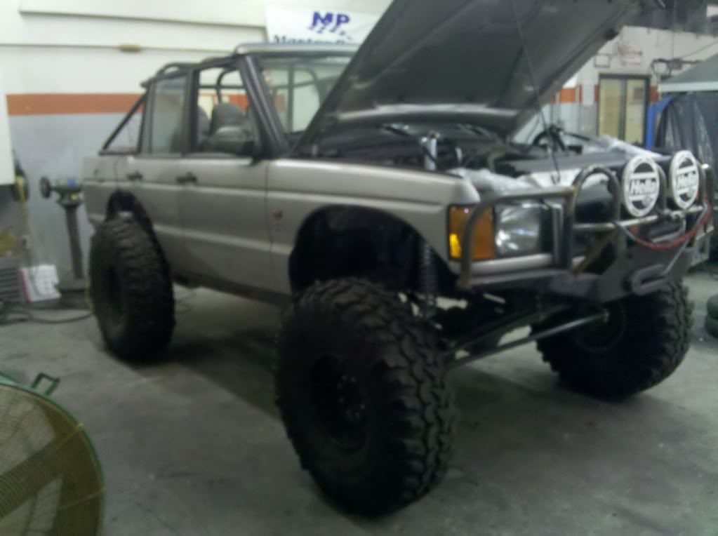

Are you sure you have enough body to tyre clearance once you articulate those axles?
AG.
Assuming there is no sarcasm and you are serious, it's trimmed so that sitting on the bump stops, it has about 2" - 3" of clearance around the tires. I've actually set it up to be able to run 42" tires if I ever decide to lose my mind and go bigger.:shaking:
Rears are 14" travel with 16" 200# & 14" 175#. Fronts are 16" travel with 16" 300# & 14" 200# w/ triple-rates coming so I can raise the adjusters to drop the front. I have some additional rates and lengths at home so I can play with them if the ride is not correct, but so far everything seems like it is OK.

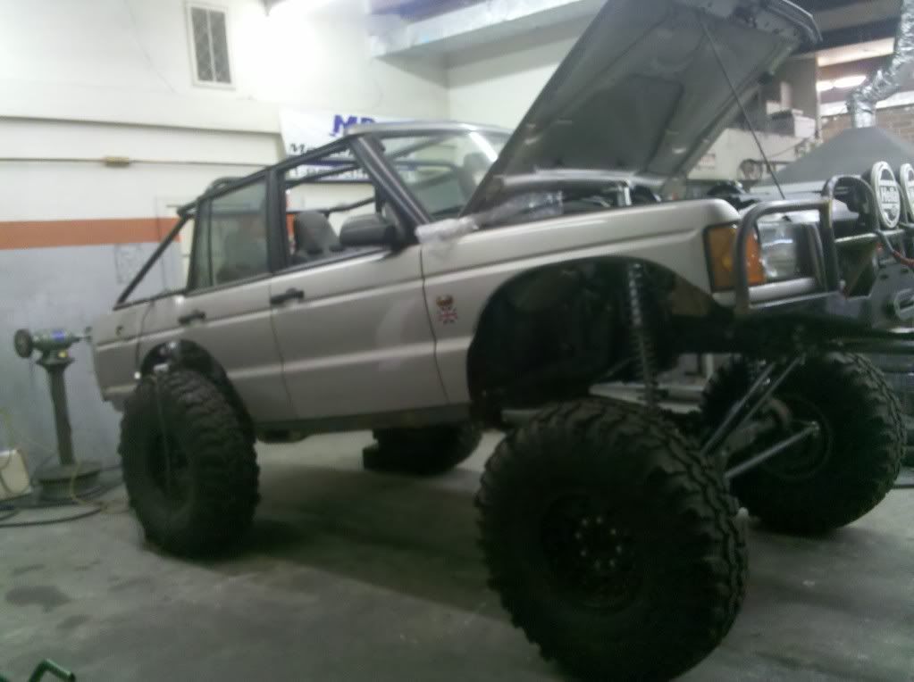

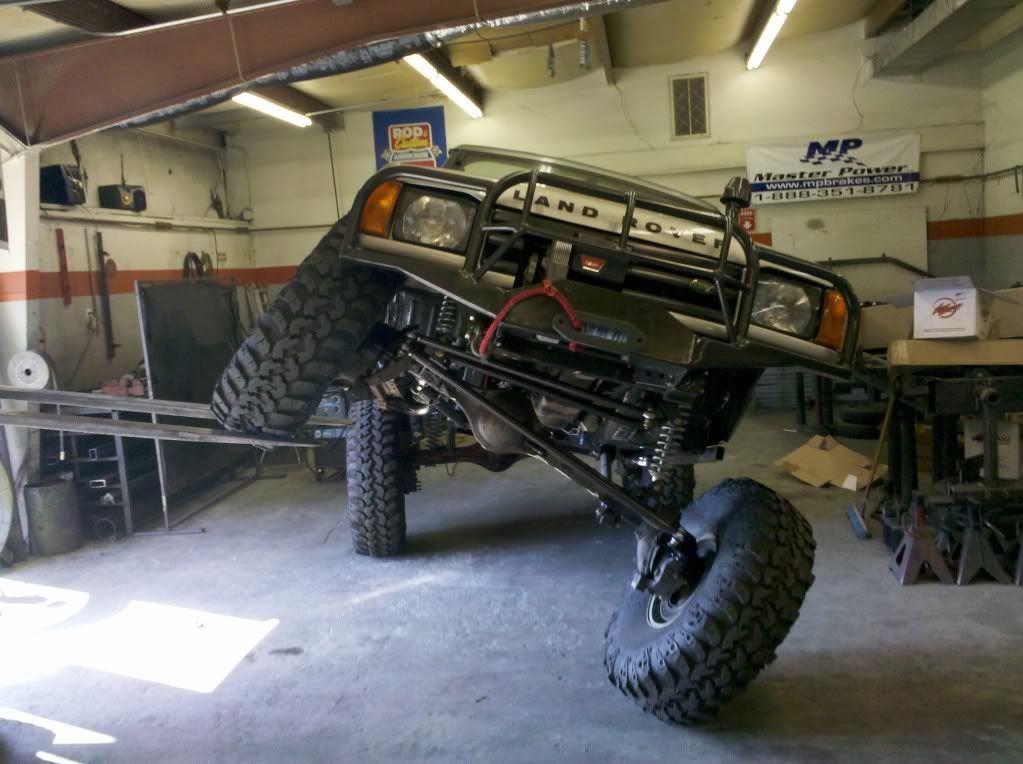

How I took it was that with the rear axle sitting on both bumpstops there is 2-3'' of tyre clearance.If that is correct, and based on experience with my own truck, the tyre on the compressed side during articulation can rise 6-8'' higher, and the bottom photo of Gregs truck indicates insufficient clearance for that to happen.
To check clearances when building vehicles, I've found it useful to make a hoisting bracket that attaches to the wheel studs, so that you can articulate the suspension in the workshop by means of a chain hoist hanging from a roof beam.
AG.
I articulated it the best I could in my garage with what I had - I guess I'll find out this spring (or hopefully sooner).

Well, I didn't get as much done as I had hoped (does anyone EVER?), but I did get a lot of little nagging things cleaned up. Just think of having to take everything off of your wheel wells (since they are gone) and relocating everything(!).
Here's the front fully extended so I could remove my coilovers and install the tender coils. I was able to lower the front 4", so now it sits just right (for some reason that picture didn't show up!).

AGROVER, you were riight! I cycled the suspension today and I have a lot of trimming left to do!!!
I'll post a pic later tonight. I'm 6'4" and the end of the front bumper was eye-level with me. It could have gone higher, but the front tire was crammed into the fender, as was the opposite rear tire.
Idid get my ram-assist sorted out and mounted though.
Here it is in a poser flex shot. Front bumpstop is about 2" from touching and rear was about 1" from touching, but I couldn't go any higher because of tire to fender contact.
