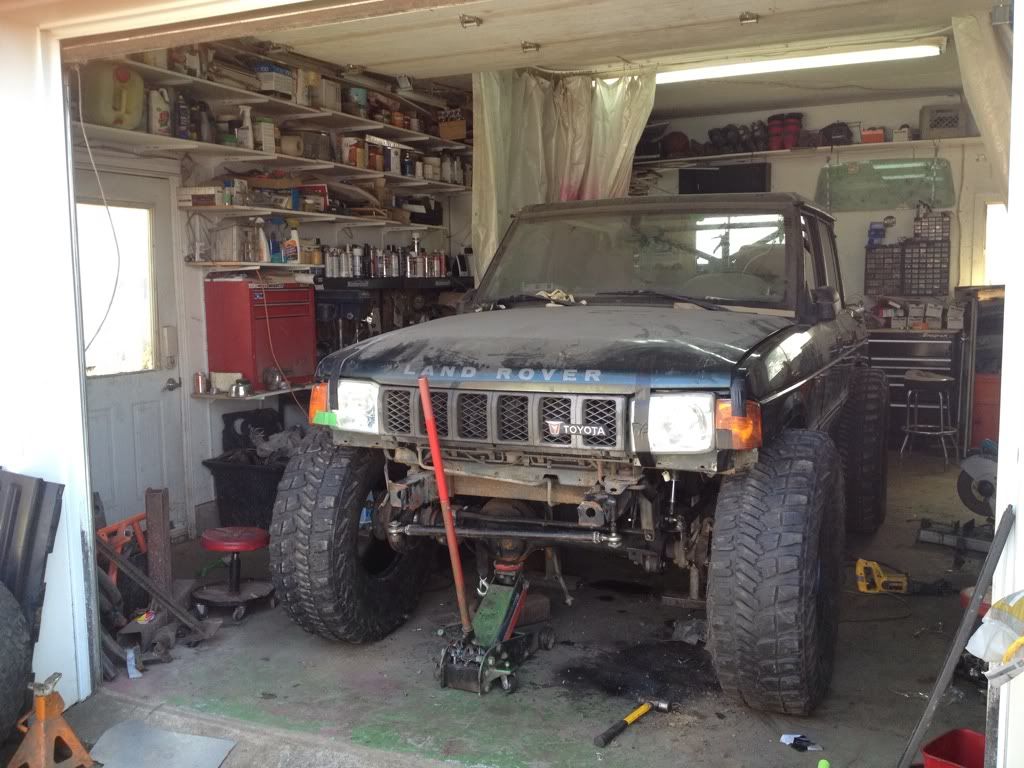

Finally got the front coilovers mounted on Friday. It is a little tall in front, but I have the adjusters threaded down so the coils won't unseat at full droop. I have 6" tender coils and sliders coming so I will be able to drop the front down 3" - 4" to make it sit level.
I still have to fab the cross-bar between the hoops and mount the rad resevoir, the steering fluid resevoir, and a few other bits under the hood that had to be moved to make room for the hoops.
Plus, I'll have to make some cuts in the hood for the hoops to poke through. But hey, everytime I remove sheet-metal, it gets a little lighter!:grinpimp:

I know how you feel! I had a clunking in my front end and when I inspected it today one of my lower control arm mounts on the axle side tore off the axle at the weld, my hydro steering ram is shifting side to side in its mount, and 2 of the nuts in the steering linkage have gone awol!
I'm hosting a local mud run on some private property on the 30th and my rig might not even be able to play :(
I ordered a Hobart 210 mig welder this afternoon with 2 day shipping, so I might get everything sorted out by the 30th.

Here's how I fixed the driveshaft angle by putting a spacer on the end of the flanges.
A bitch because all the steering had to go.
Now I have a normal pitch and it does no vibrate a 60 mph :))
Sent from my iPad using Tapatalk HDu
The vibes went away when I decided to balance my tires with air soft pellets and bought new wheels as the Hutchinsons were bent(!). All pinion angles are set and it tracks true and smooth (well, as smooth as Iroks will allow).
It's amazing at how the little things like bent wheels and unbalanced tires can affect things. :)
