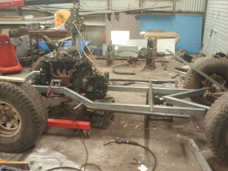

started off with some 2x3" box for rails, set the wheelbase and mounted motor and box

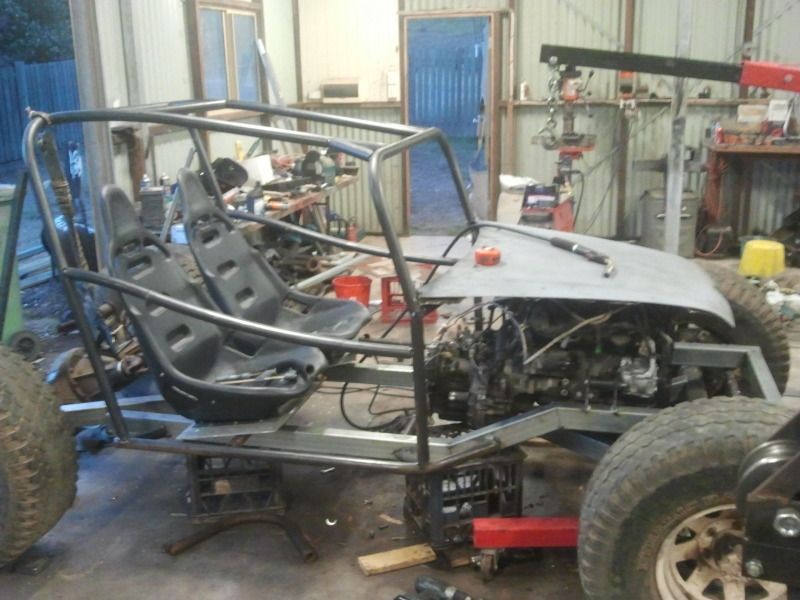

chopped up the metro hood to give it a vw buggy look, still have to extend the hood over the nose a little
added some tube and mounted front shocks
working on rear now and a sliding peddle box and wheel for different drivers

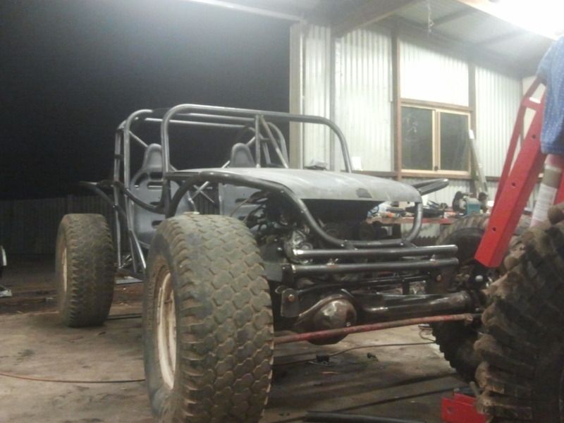

got a few hrs on it today so a few update pics
yet to brace up the panhard mounts in the rear.

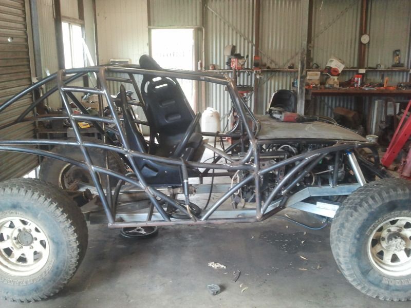

Discussion Starter · #10 ·
steering mocked up, as well as fuel cell and radiator fitted up in the rear, rear rad is not my usual style but the shape of the bonnet didnt help

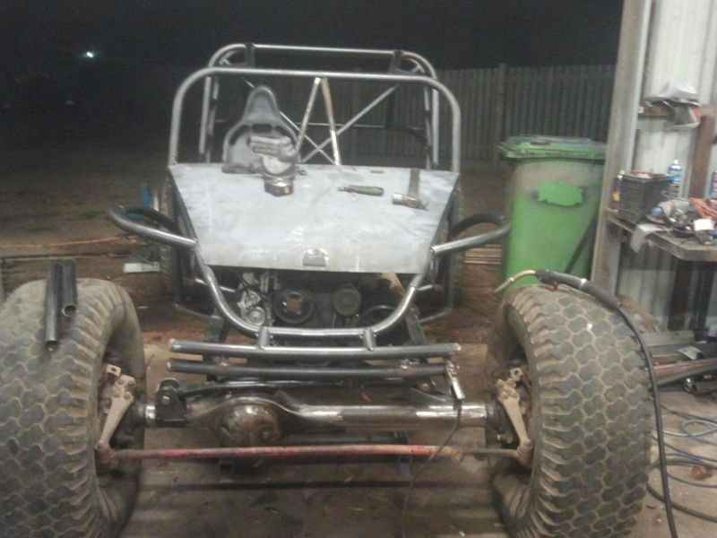

Anyway to cut a long story short, work got flat out till after Chrissy, but I have found a little time to get it done
