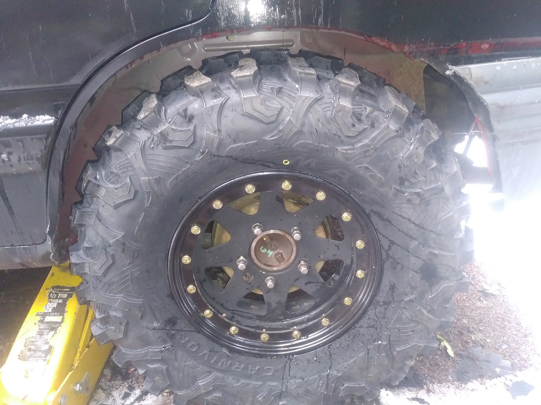

Half ass put it on the front. The later "vitara" calipers stick out further and won't work with stock Sami wheels. It's only like 1/2" at most, but the smallest spacers I saw were 1" so I ordered a pair. If they aren't enough, I'll order some 1.5" and put these on the rear. Pic is at full droop.
It wouldn't fit even at ride height with weight on it :laughing: I trimmed the bumper and beat in the front of the wheel well so at least it will roll around on flat ground. I only have 5 tires for each, so I basically need to get the 32s on the 4 door so I can have rollers for the 2 door. :laughing:
Also got the auto pulled, that was more of a pita than I expected. It's hard to get to anything with the inner fenders in the front. I just want to pull the coil spacers off the 2 door and then kick it out side and start on pulling the 5spd. Hopefully by the time it's out, I'll have my parts from trail tough.
I also need some type of trans cooler. I had really good luck with the heat sink cylinder type with my full hydro on my other rigs but I'm not sure if it would work good for a trans.

Made some steady progress. Got the parts I need off the 2 door and kicked it outside. Also finished all the wheels and mounted tires.
Tacked rings
Cut off lip
Welded every other span, then grind a bevel about 1" into the ends of the weld.
You over lap the welds to help it seal. That way you are nice and hot by the time you get to the end of the last weld. If you try to start in the same spot, it will leak, every time.
I'm sure some people are wondering why in the fuck I cut the lip off the wheel. Well for one, there was a huge gap that I felt would have been too much to fill. 2nd, I always hated how hard my last weld on beadlocks were to mount and dismount compared to a manufactured beadlock. I've noticed that manufactured beadlocks have a smaller OD on the outer lip, it doesn't need to be the full OD since it's bolted in place. I'm confident I won't have any problems, but we will see.
Looking like something finally
Started tearing into the 4 door just a bit. Gotta pull the trans and both diffs, plus install coil spacers. The 2 door had 2" rears and about 1.5" in the front (which I assume will equal 2" lift with the leverage of the a arm) Does anyone think that will be too much without any other changes? CV angles? Rear link bind? They're aluminum, so I could get them turned down no problem. I had really good luck running 35s on my ifs 4runner and I believe part of that was because I left it all stock. No extra stress on everything by cranking the t bars.
