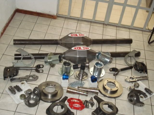

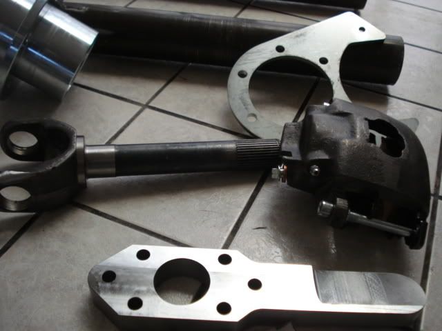

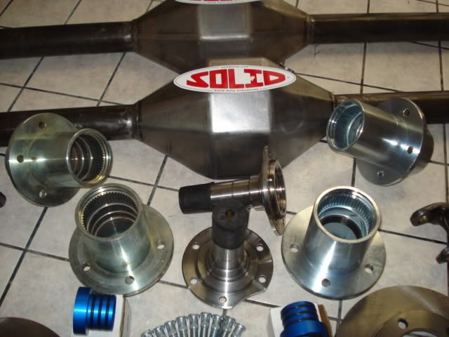

Gathering parts for front and rear 609's for my TJ. Currently have cromo d44's and 35" tires. Stepping up to Spidertrax housings, hi9's and Solid Axle outers.
After living a few years south of the border (Mexico, in petrochemical/ plastics field) I finally found a decent fabricator I trust. So we'll see how this goes.

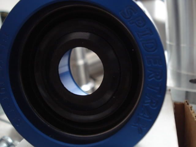

Do those inner axle seals really seal, or just slow down the oil??? Cant really see a cheesy single lip seal without a kicker spring really holding back oil!!
1,248 Posts
You might consider adding a second inner seal. The Spidertrax Seal housing will allow more than one seal.
Exactly. They do seal double lipped. I've run mine on the hiway a few times, and they stayed sealed.
Bummer you decided to go with hubs and bearings. You must be in dry stuff. Those are my only regret besides my shitty WE coil overs from my build.

The double seal is not pictured but it's there.
my only advice to you on the seals is to grease the ever loving shit out of the end of the axle shaft before you stab that bastard in. If its dry you run a very large risk of tearing the seal.. and when i say grease, the more the better!! that's the only draw back I have seen to these seals.

what made you decide to go with solid's ends rather than the spidertrax ones? with the roller kits it is reasonable for how much we can put into these things haha.

1. Mike @ Solid Axle. He set up roller kits of the parts I needed (not any predetermined setup).
Gotta give credit to Tom at Spidertrax credit. He setup free shipping the day after I asked for a quote.
2. Ease of using Chevy parts anywhere (dude I'm in mainland Mexico as we speak and Chevy parts are everywhere).
