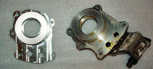

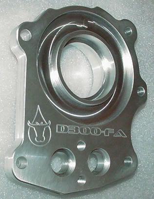

We are milling out protoypes and this is the idea ....ok
1. A whole new face plate enabling the shortest shift rails
2. A mount for a cable actuated system form the bottom of the case
3. Face mount comes complete with seal and inner bearing race installed
4. Face mount also comes with shift rails, bushings, orings installed
5. Face mount allows yoke upgrades up to 1810
6. Top plate milled for large 4-1 gears and has tapped holes for breathers, oil sight tube and fill
The whole point of this is to make a adaptor that allows you to completely replace the front casting/shifter rail assembly. This is a no brainer bolt in flip kit that a 5 year old could install with little supervision. We are nearing completion of the first kit as I type this. More on wednesday. We have a super trick cable shifter that will mount anywhere and make the current shift assemblies look like toys as well as kits to put a 20 case where a 300 was (more info later).

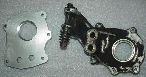

Man that really cleans up a 300 case :O
Before
After
oh yeah I forgot to mention this part has a Patent pending protection for one year...for the copy cats :D
