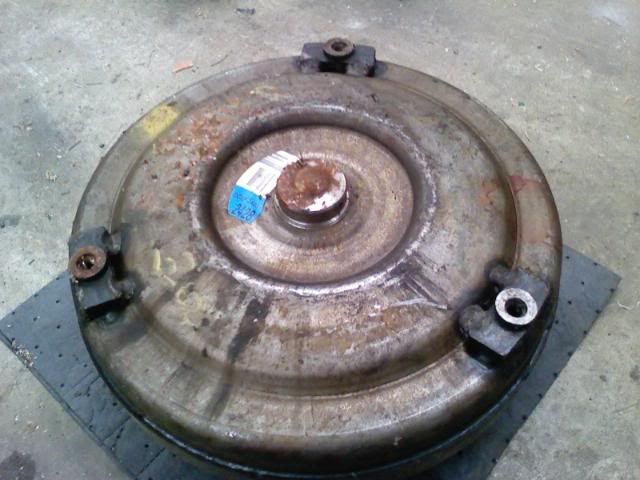

So to use the 4l60 with the Gen III GM changed the torque converter by adding a longer nub on the center hub that contacts the crank to support the TC. As well as going with a metric TC spacing.
Gen III converter with long hub
(need a better picture as this is not mine)
SBC converter note smaller shorter hub

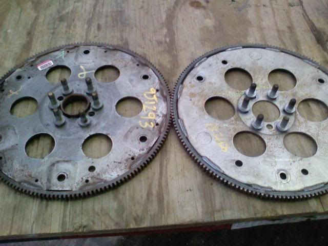

Gen III engines with a stock 4l60/65/70 GM uses a dished flex plate. Note its the one on the right with the shorter crank bolts. The flat flex plate is on the left note the longer bolts.

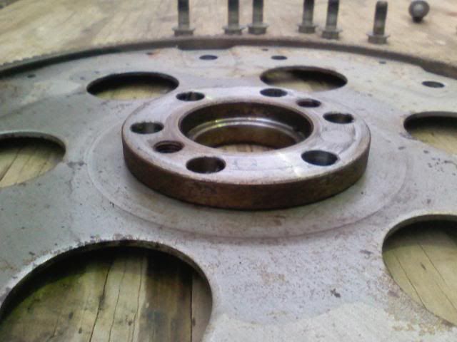

On Gen III engines using the 4l80 trans which uses a convter with the Gen I style center hub GM used a Flat flex plate and a spacer mounted between the crank and flex plate. This mounts the TC flush with the center hub and it slides into the spacer to support it.
The flat flex plate has the spacer on the fwd side facing the crank.

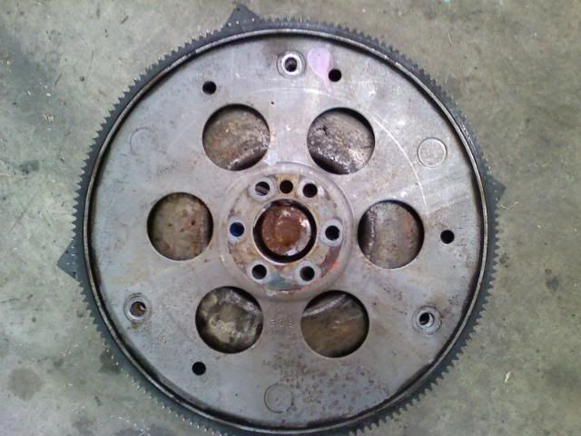

Dished 5.3L flex plate mated to a SBC Gen I converter. Note the hub is un supported

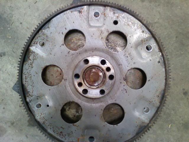

Flat 6.0L flex plate and spacer on a SBC converter. Note hub is supported by the spacer.

2) Use a 6.0L flat flex plate with the spacer between the flex plate and crank. Note:the spacer is part of the flex plate ie its installed onit and should come off with it.
The spacing of the two flex plates when attached to the crank are the same IE the teeth of the both flex plates are in almost the same location. The dish of the 5.3L flex plate makes up for the spacer. So any Gen III starter should work.
