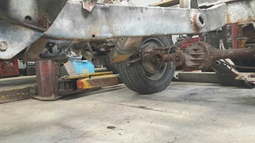

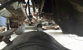

Finished up my TCase cross member, looks decent enough to me, but I don't know why anyone let me in the same room as a welder. I think we're ready to start test fitting the body.
I tried to keep it as low profile as possible.
Feel free to criticize my welds, for they look like garbage. Any pointers are more than welcome.

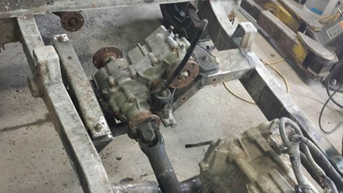

Test fitted the body this week, apparently we had mounted the engine 3 inches too far forward and the Rad wouldn't fit. it took some time to get it moved back, it now fits with the firewall and probably the stock Tracker rad.
Rad wise, my only concern is steering box, but we'll cross that bridge when we get there.
I made up a new transmission crossmember. This one is fairly adjustable if we need to move it again, I won't drill the holes until I know that it's all in the right place.
We also made a few tunnel and modifications to get the auto to fit.
