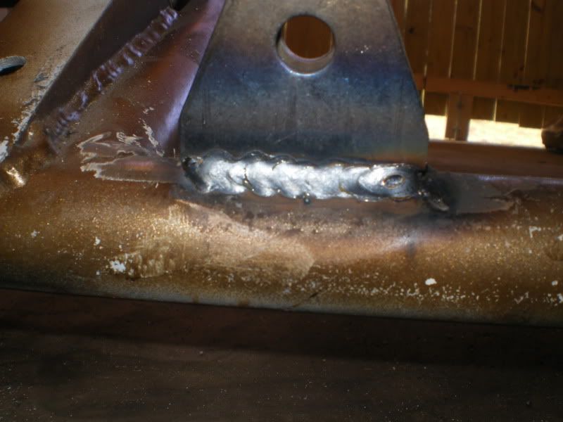

Next I got started on the spring hangers. I made these out of 3.5" square tube. Next time I'll just buy the damn things...Its amazing how much time little stuff like this takes when you're new to fabricating.
I think they turned out ok. I still need to put them in a drill press. Then I can get started on the frame cuts and start frenching them in. No turning back now.

351 Posts
Looks great! For a beginning welder, your spring hangers look really good. I am subscribed!
You didn't say, but I'm assuming you will be staying really low with the build. Going SOA (I assume) with the sliders will give you a really low stance, which should work great!
Plans for fender cutting?

Thanks! Yeah, I want to stay really low, SOA. With the belly up stuff, I figure the lower the better to keep COG to a minimum. I haven't figured out the fender cutting yet but at this point I think there will be a quite a bit.
The nice thing is if it sits too low, I can always go up to a 2" spring or something. That would only be if up-travel was a major issue though.
As far as the welds..thanks. I'm still learning but I have a pretty good idea of what NOT to do...so far. :D
