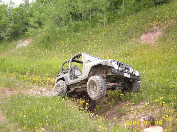

HP44/9", 4.88's, lockrite/detroit, 3 link / 4 link, 37" Pitbulls on beadlocks, and lotsa home made sh!t.

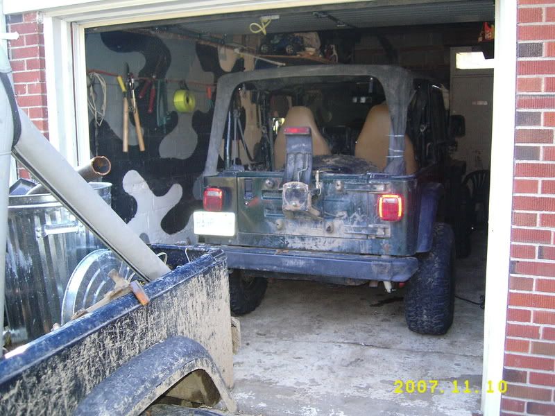

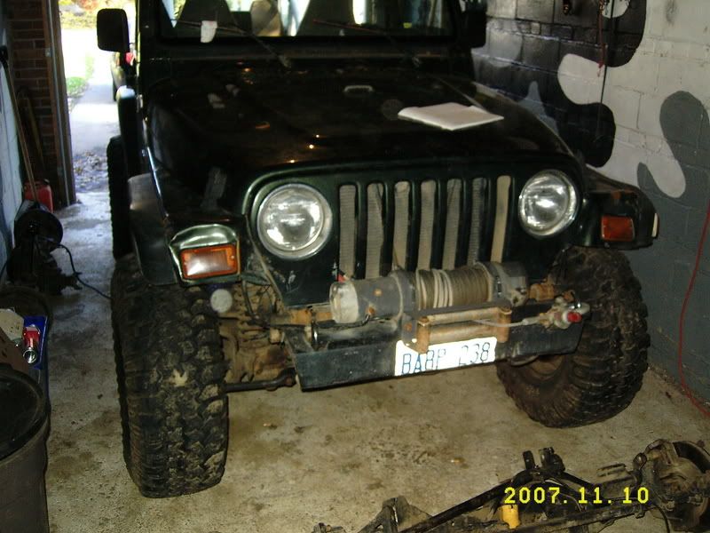

Ready to be gutted

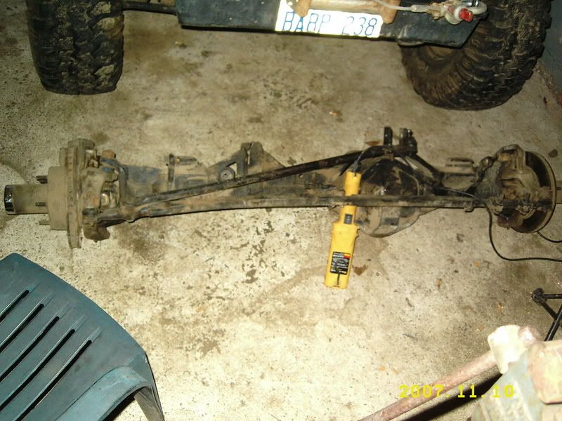

Out with the old
The goods

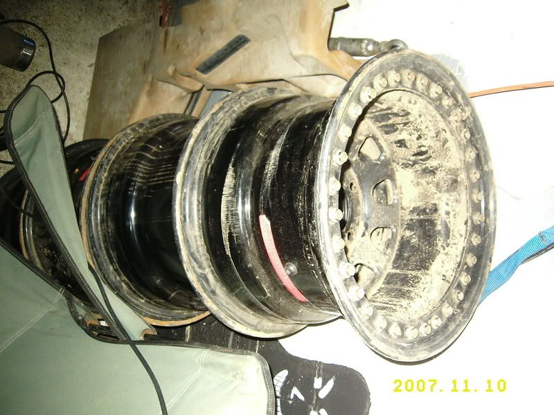

Did up the beadlocks, what a fawkin chore :banghead:

Slapped it all together to check for clearances, heights, etc. as well as some ghetto driveway flex.

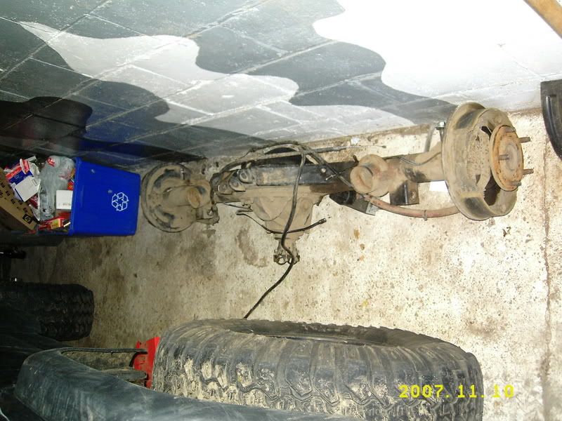

Then ripped the rear apart for some final burning and painting.

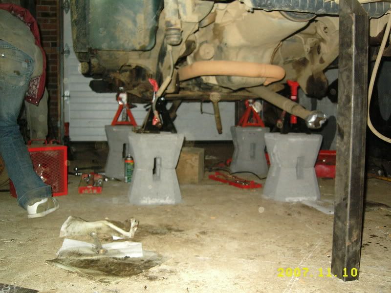

Work with whatcha got buddy. :flipoff2: That was a little greasy but heh. The blocks in the garage only stayed that way for a night. :eek:
Still a little greasy, but i'm still here.

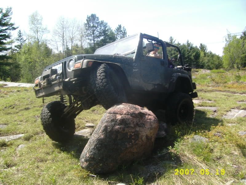

Like your homemade rear shock hoop. What travel shocks are you running in the rear ? Dont know how to read 4 link calc, could you tell me your suspension link lengths ? You are stock wheelbase ?
Thanks
462 Posts
Discussion Starter #20
Whatever the biggest bilstien 5125 are. 14 and a bit of travel front and rear. Might have an inch or 2 over stock. I'll have to measure the links for ya when i get a chance. Pretty busy getting ready for this weekend. Went for a trial run and found some bugs that i need fix. I'll update the thread next week.
