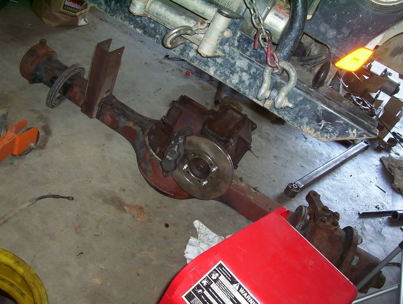

well i burnt up my chopsaw so i couldn't build my rearend tonight like i wanted. I got some other shit done tonight that needed to be done, made my front driveshaft, finished the front pinion brake and mounted the rear also. I'll go get a new chopsaw tomorrow and mount the rearend and i'm also gonna pick up a hydro cylinder and get the steering finished up. Here's some pictures...

Looks like you have some potential there. I suggest you clean up your metal a bit more. Grinding is fun and chicks dig it.
I am assuming you are not done with that front spring mount?
On a side note, the mess in your shop would drive me nuts. Get the old lady to pick up some :)

no i'm gonna add a brace on the backside of the spring pad to strengthen it up a little. Yea i know in the first pictures the garage is a wreck, i cleaned up yesterday before i got started working cause all the junk was starting to piss me off. Also i do usually clean the paint off the are i'm about to weld with a wire wheel on my angle grinder, all the brown on the control arms and frame is primer not rust just to clear that up.

I hope you fix that awful wristed radius arm set up and convert it to either full radius arms, or 3 link.
Agreed. I'd go to town on that hill-billie suspension with a plasma cutter and a sledge hammer. Maybe put some wheel brakes on it? Sorry not a fan of the pinion brake but to each his own.
Good ideas to begin with (even though this thread is 5 years old), but the execution of the single radius arm, the pipe cage, angle iron coil spring mounts and 1 link all bring the suck.
Hopefully as a new owner you will unfawk this suspension.
