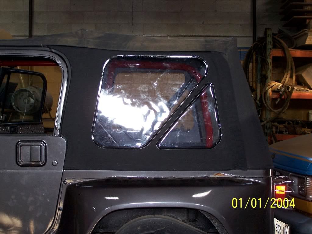

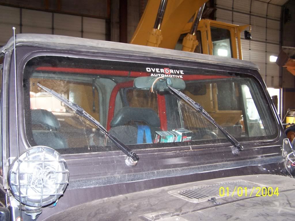

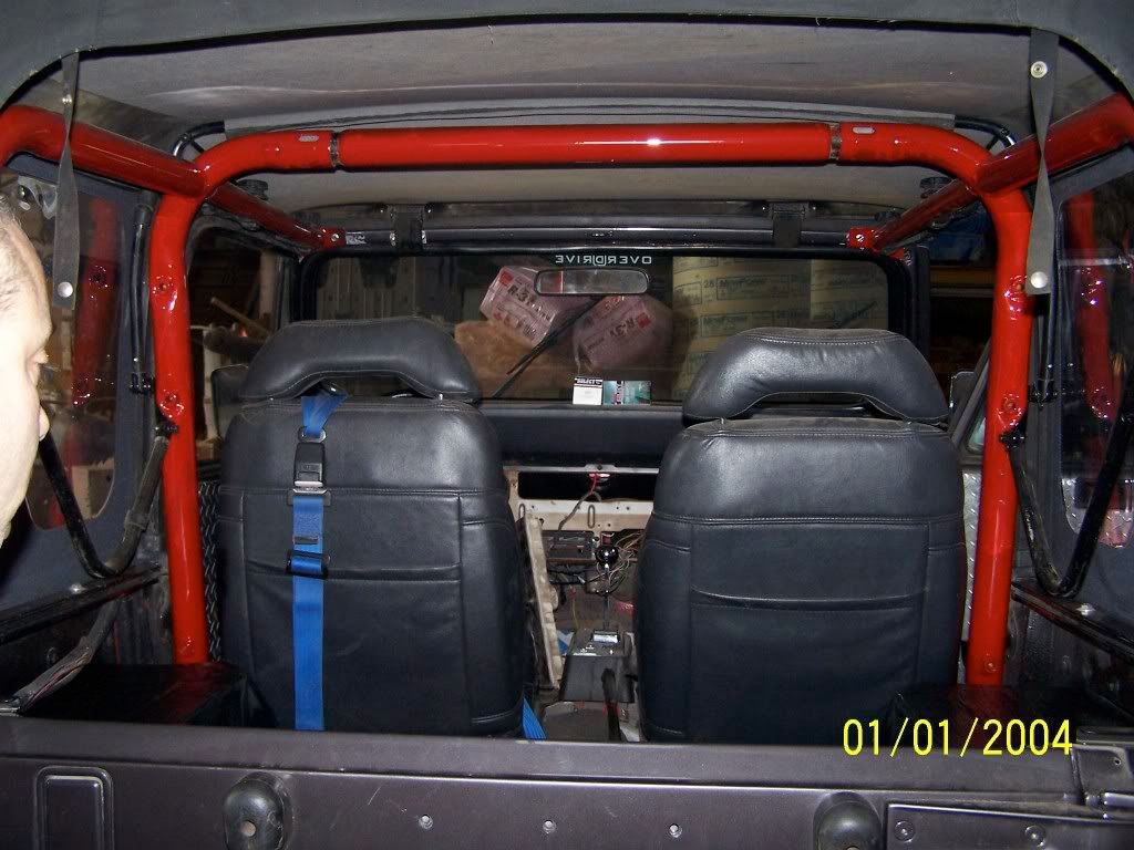

I just finished this swap and it was a PITA, seems like the editors omitted a few things in the write. All in all it well and the old adage stands correct, MEASURE TWICE CUT ONCE!!!!! The TJ cage was a little more involved than what it seemed like in the article, the alignment is very difficult to achieve, no matter how much I zoomed in on the pics I could not tell if the TJ cage opened all the way to acomodate the width of the YJ and it doesn't you have to leave a little space between the mounting base and the outermost side of the tub and fill it with a spacer. It works so much better than the YJ top that it makes all the swearing and the creation of a new olympic sport, tool launching worth i.. Heres a few pix hope you enjoy..
Before you ask, Yes it's a 91 renegade on an 03 rubicon frame and 8" skyjacker doubleflex kit and the motor is a 350 TPI backed with a 700r4 with a shift kit and corvette servo, 3" exhaust from headers back and passed emission standards here in Canada. Leather seats from an 05 jimmy mated to YJ risers, Grand Cherokee brake Booster, TJ hood latches, tailgate hinges, and now TJ soft top, I called this project YTJ Please don't mind the date I took these on Monday
Dave

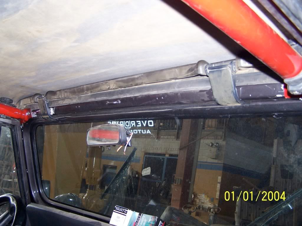

Very nice! I have been planning on doing this when I build a cage for my CJ. Any chance we could get some pics of the holes you cut in the windshield frame to accommodate the latches for the soft top?
Also did you use the YJ soft top hardware that bolts around the top of the tub, which creates the lip for the soft top to tuck under? I've been thinking about pulling the lip off a TJ tub and spot welding it to my CJ so I wouldn't have to pull it off to switch between hard and soft top.

I will post pics and write up as soon as I finish it, There is no YJ hardware at all, I used the TJ windshield seal and cut the corners of the windshield to accomodate the round corner of the top. The holes in the windshield frame are square about 1.5" x 3/4" rectangle, I reinforced the holes with a piece of checker plate screwed to the frame. There is no lip on the TJ top that hooks into the header, just the latches provide enough force to seal against the TJ seal. I used my YJ doors and they are about 1" shorter than the TJ doors so they dont seal 100% until I change the doors to TJ ones.

Cool, but what did you do about the hardware that bolts to the top of the tub and goes from the doors back to the tailgate. That's the hardware I was referring to. I'd like to see some pics of how you got the seal on top of the windshield frame to work.

I used the YJ body pieces because the TJ has it moulded in to the lip of the tub, The only thing you have to do is notch out the front closest to the door in order to fit the TJ door surrounds

I always wondered why use the stock tj cage instead of just putting the mounting tabs onto the yj cage? is there something more I'm missing?
113 Posts
Discussion Starter · #13 ·
The YJ spreader bars are to far apart, the won't allow the door surround to sit in the right position and the top won't close and neither will the door
