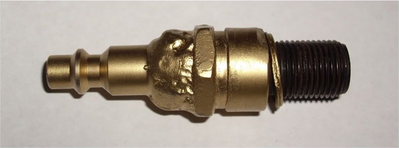

Break the ceramic off of and hollow out a spark plug, weld it to a male quick disconnect, slip on some 3/8" line and screw it in #1 so you can easily feel the compression stroke while you're laying on your back under the truck turning the engine over by hand.
Oh and obviously it only works when you paint it gold. (Made it easy to spot in the toolbox).
