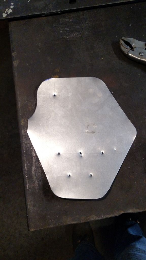

I found that aluminum roof flashing works better. It can be cut with scissors, is oil, fire,water and mouse resistant and you can punch your centermarks in it. You may be able to plasma right around it if you make it smaller by half your plasma's tip. I tried to get overly fancy and use magnets to hold it just above the material, but that didn't work well.

I've got a cheap Norther Tool plasma. It's got the cheap Trafimet S45 torch. I get the cheap drag tips from Ebay and use a straight edge or 1/4" MDF template to cut almost everything. I make templates from cardboard then transfer them to MDF. The transferred template needs to be over or undersized by the width of the cutting tip. I ground the end of an old tip flat, and drilled out the hole for a ball point pen. I just trace the part to be cut and the my template will duplicate the part.
