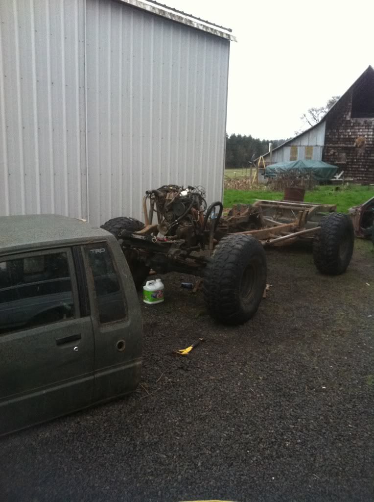

This weekend was fairly productive, cage has been removed and sold. Interior, wiring, and fuel lines have been pulled, cab and bed have been lifted of and ready to be sold if anyone locally wants em:flipoff2: plans for this week are getting harness pulled and cab mounts moved on frame and hopefully get the can set on by Friday. Pics up soon as stuff gets done.
Current condition as it sat yesterday.:laughing:
Took some measurements last night and found that the rear can mount only needs to go back about 8-9" ish and I'm debating on moving my rear axle back so it's a little more proportional to the cab but well see.

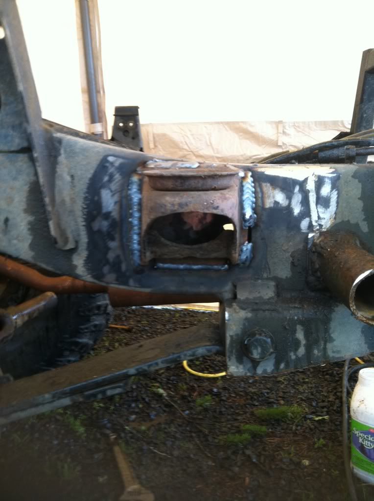

This weekend has been fairly productive for me. Yesterday I managed to get the rest of my old chassis sold deliverer the bed to one town, cab to another, then drove south and picked up a bed and tailgate so I can run skins.
This morning I finished cutting off the forewardmost bed mount and I welded on the new cab mounts. Did some measuring and this is what I got for future references for people doing this swap or whatever.
Center to center of third gen front mount to rear mount is roughly 61.75" and the rear mount on the 2nd gen center to the center of the new rear mount is 9" give or take an 1/8". I should have this cab dropped on the frame today if all goes well and then it's a matter of slapping everything back together in the interior and building a tunnel and a cage.
