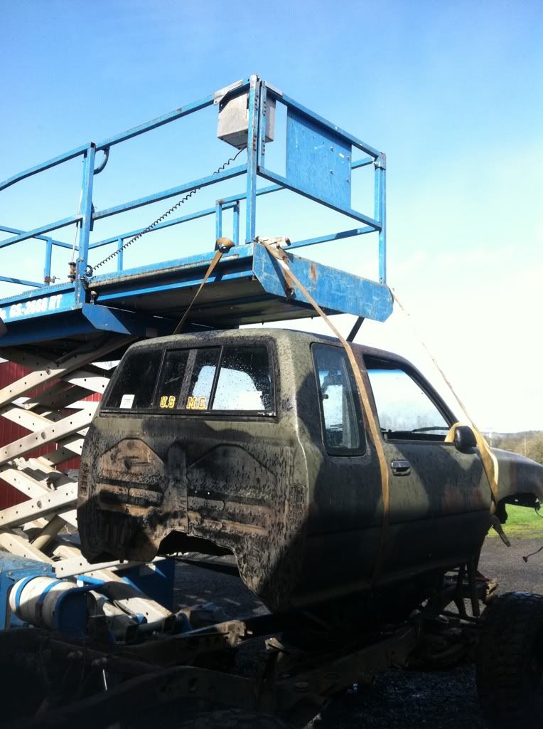

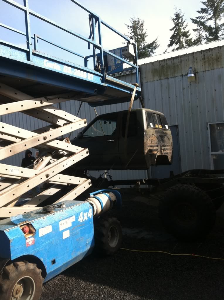

Well got the cab on. Gotta love having work eqp. at home:laughing:
Still have to do a little trimming and it's ready to re-assemble.
More to come this week.
3
Scissor lift to "lift" the cab, I have seen it all now. That cab looks sick!

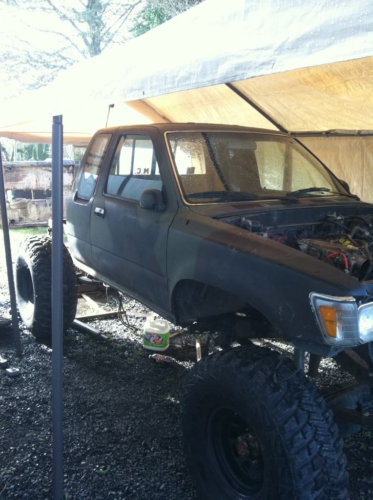

whats with front tires?
Let a buddy use two tires for mockup doing links.

i use man power!!!
I'm lazy :flipoff2: an I fucked up my back and shoulder when my buddies dropped my last can on me.

cab looks like you got alot more engine to hood clearance. is cab all the way down on mounts?
Not yet still gott trim out tunnel and the inner fenders to clear the shock hoops. Then it should be good.

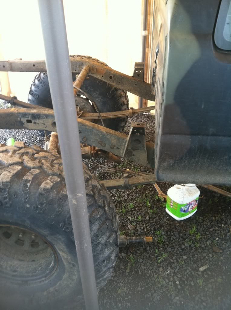

Last night I got the cab all bolted down and ready to reinstall the harness.
Here's a pic of he clearance from tires to cab in the rear.

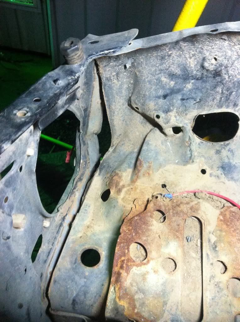

Been a little productive tonight. The passenger side inner fender and core support was bent up and smashed pretty bad. Ended up cutting it off and grafting on a 2nd gen frot core support and inner fenders. Everything lines up great
Smashed parts
Buh bye
New core support ect. Mounted up fenders, hood and grille.

i grafted a 90 core onto a 86 2wd a while back and i noticed the 3rd gen core sits lower on the front than the second...so idk if you will find that mounting your 3rd gen fenders will be to high...
I noticed that when I was taking some measurements and found that the 3rd gen is roughly 1/2" shorter so there's a little gap between the hood andthe grill. But I can fixit and it looks better than having another front end that looks like it has down syndrome. I need to get this thing going so I can wheel again.
