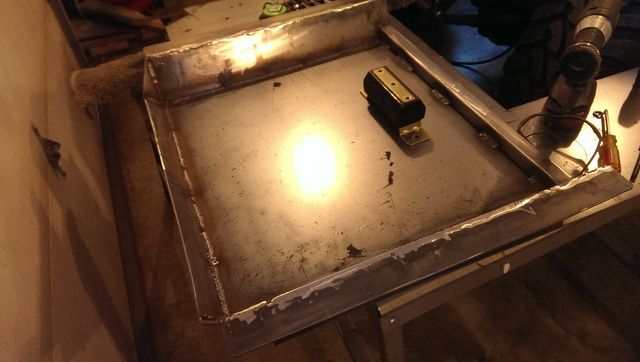

I did actually make a little progress on the Willys. I constructed a skid plate for the transmission and transfer case. I constructed it out of 3/16 plate and used some square tube bracing for strength. I will mount the transfer case/transmission mount on the skid plate to replace what I had previously built for it. Here are a couple photos.
