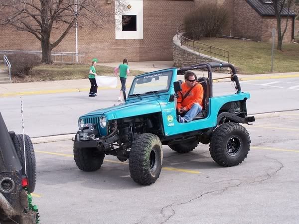

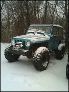

Kelly(BlackSheep10) owner of Vertical Limits in Paola, Ks. is building my 97 TJ. This build started easily 2yrs. ago. It started as 97 TJ with a 4.0, auto., a/c, 2in. Pucks, dana 35 rear Jeep. I unbolted the fenders, comp-cut the rear and welded up the shitty 35, then put on some 36in. bias Iroks, and waited for the 35 to let loose. It actually lasted over a year of hard wheelin. Here is the TJ then

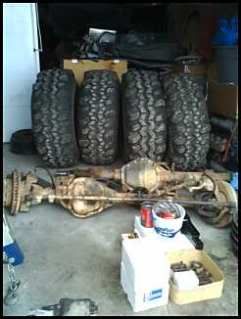

so during this time I bought goodies for the swap
and after it broke I parked it and started disassembling it with the help of Doug and Heath from D&D Performance.
