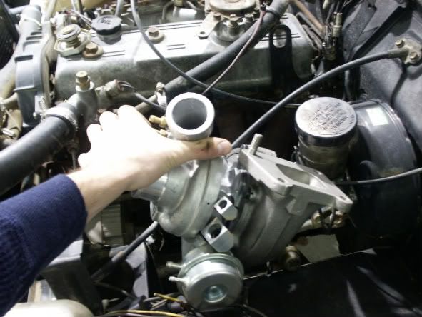

Starter
With keeping the Toyota starter in its stock location there are clearance issues with the turbos on most engines. this can be overcome with a small 1.0kw starter. The starter will still suffer some from the heat but it will work. Wrapping the starter in header wrap might help or building a heat shield.
A larger 22re starter hits the Turbo(Vnt15), Smaller ones are work but are still close.
NOTE: A small section was taken from the piece of the thin plate between engine and trans from original Toyota setup and trimed a shim for proper started spacing.
