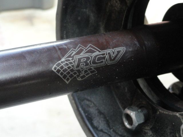

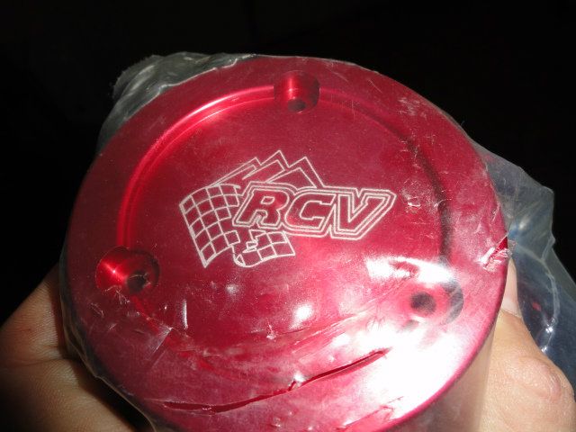

I decided on the RCV front shafts, with 30 spline outers, along with their 30-spline drive flanges. My thought is hopefully these will be last shafts I buy for this axle and find out what else is week in my drivetrain!
Ultimate Dana 44 CV Axle Set for Jeep Wagoneer ('80-'92)
Yeah I could have went with chromo shafts, some Longfield u-joints and Warn hubs.. but since I had to sell the quad for parts, I knew I would not have this opportunity for a long time.
My setup:

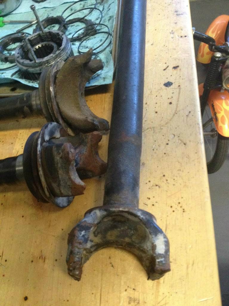

1986 Wagoneer Dana 44, DS diff, high steer, leaf sprung, Ox Locker.. basically old school SAS, because it was, done initially back in 2003. I broke both inner and outer ears as well as both U-joints. The premium MileMarker hubs were also found to be trashed upon disassembly.
Well I knew the install were going to kick my ass, but more of a complete bare knuckles knocked-out ass whoopin is what I got. This whine-session is to provide light for anyone thinking of going with the same shafts, with some tips of what worked and what didn't that I found out on my own. There were no instructions in my box, and the You Tube videos and a few right ups were read, but did not seem to have the same problems as I had.
Of all the research, I knew you have to grind down the lower ball joint to be flush with the nut.
But what I wasn't expecting is how much clearancing was necessary to get the knuckle to open up as much as possible and to squeeze the CV onto the the inner shaft with the boot in the way.
Starting with the Pass-side I fought, and pushed, and squeezed, and grinded, and grinded, and grinded and fought and could not get that CV into the knuckle. I kept hitting. Well what I can tell you NOT TO DO is warm up the boot to temporarily soften it. Needless to say I ripped the dam boot and it permanently distorted it. Cost for a new boot is $60 and at least a week delay. :banghead:
I just couldnt make it fit, it almost seemed like it wasnt the right kit for the axle... so I started on the driver-side hoping to get one side done and for better luck.
More of the same... grind a crap load. But it's in! And this is how:

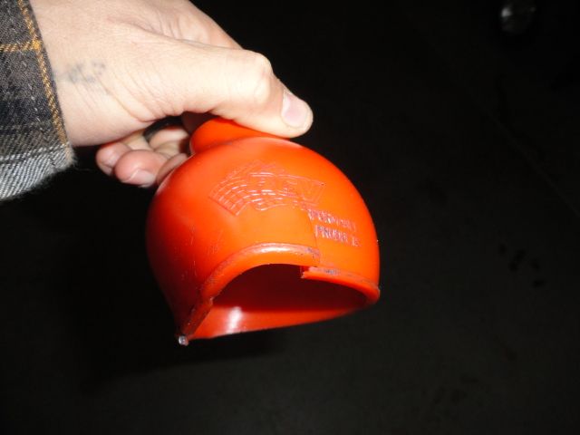

Fighting the Boot. I did this several times until I finally got it in:
-I coated the inside of the boot with the supplied grease for lube.
-Once the CV is starting to go in, you are pressing it against the orange boot "seal". I found by NOT heating it up, I could use an old dull Toyota tire iron to stick in the boot and gently pry out out from being smashed. This really helped to align the CV and kept it from popping back at you. You have to keep pressure on the CV while doing this.
-I used a rubber dead-blow hammer to convince the CV it wanted to go in.
Pop... I got the CV to get past the knuckle!! Now the knuckled the turn again and you can align the splines of the inner shaft and CV.
-I pulled the boot outward so I could fit a pair of needle-noted locking pliers to old the shaft inside the axle tube. Do this so the boot will stay put while pressing in the CV, otherwise it goes into the tube.
-I used the stub shaft, though the knuckle, to help push the CV into the boot. Unfortunately for the install, good for the CV, air does not escape when pushing in the CV, so it pops back out.
-I used dull pick and stuck it through the now empty spindle bolt hole and into the boot, while pushing the CV/stub shaft. I then used an angled pick on the opposite side to gently-forcefully opening the boot and somehow it went in and stayed. If you counted, thats 3 things at once and it was only me. Today I used my stomach for more than eating... used it to push on the stub/CV while my hands did the prying... Reminded me of the time.... haha

Well the boot came in the other day and today was the day rain or shine to put it all back together. The rain came, and the truck is still not together. I borrowed a friend to drink with and we were able to get the pass-side cv into the knuckle for most part. We worked the boot around the cv, but could not get the cv onto the splines enough to close the knuckle to work in the cv better. The wind, rain and bound-up slippery cv won todays match. Hope to find some time tomorrow to try again. :shaking:

Well since my last update, it was a little drier outside so back at it again.
I put a call into RCV during the week for some guidance and spoke with Kraig. He seemed genuinely interested. Surprisingly he mentioned the inner shaft could be slightly trimmed (1/8" or so) to all the CV to squeeze in the knuckle easier.
In the process of trying to knock the stuck CV out of the knuckle from the night before, while opening/closing the knuckle.... the CV popped into place! Imagine that!
So after we slide the CV into the boot, and rebuilt the spindle and caliper bracket, we started pumping the supplied RCV grease through the needle tip zerk at the end of the stub staft. This has to be done before finishing up the hub assembly. You can hear the air getting worked out and turning the knuckle helped work the grease in fully.
I'm glad this worked out, as I was not too excited to trim the inner pass-side shaft.
Another Don't: Don't pump too much grease as this can push the cv out of the boot. We learned the hard way as this pushed the stub shaft outward too much to not allow the flange cover to be installed. This also allowed the seal to be broken between the CV and boot on turning to the maximum. With the wheel/tire on I cannot steer to maximum any ways with my setup, but we pulled out some excess grease so we could push the stub shaft in enough to clear the flange cover.
