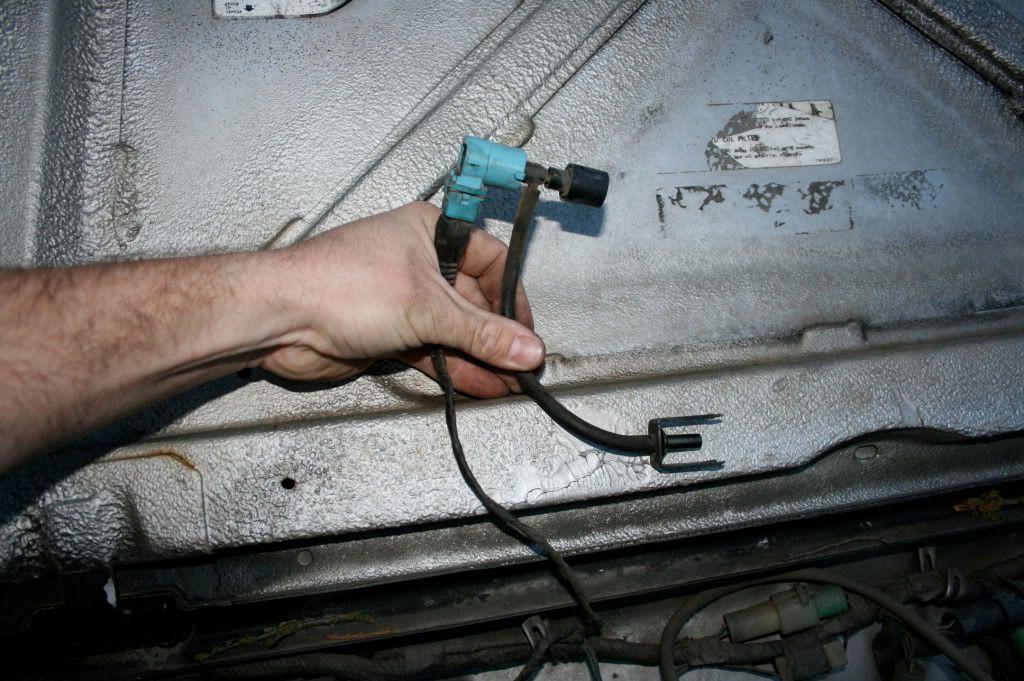

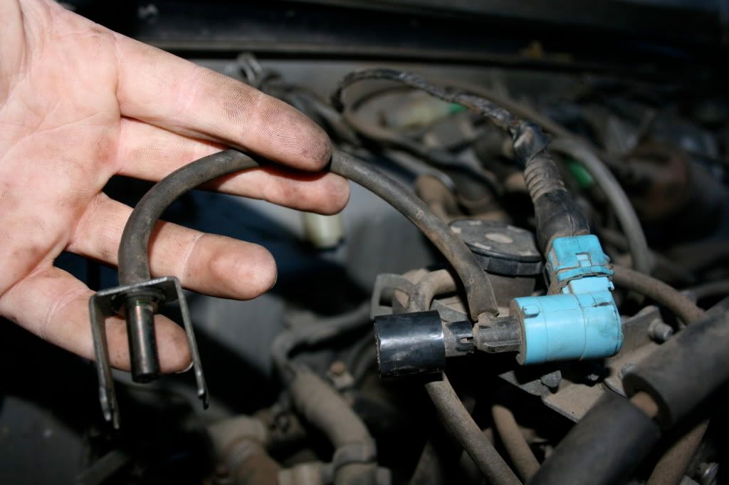

This was dangling back behind the air filter next to the distributor. Sammi runs, so I'm not sure where this goes. I looked around as best I could but couldn't see anything obvious.

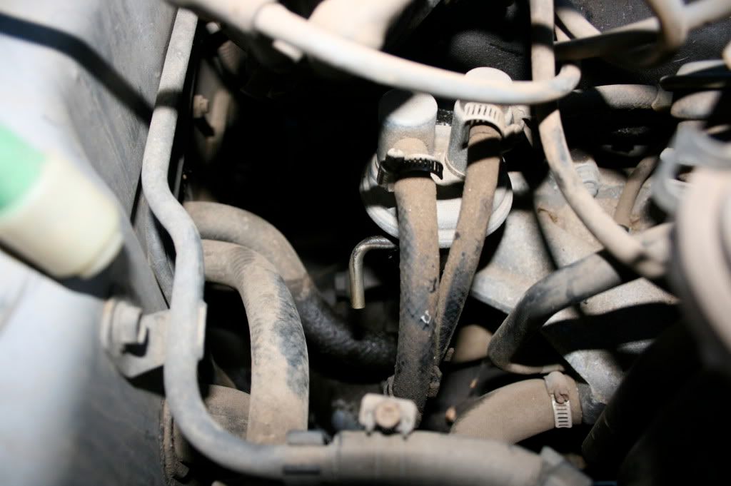

Also, I noticed this diaphragm just below the distributor has a little tube sticking out of the bottom. Should this be connected somewhere?

that "diaphram" is really your fuel pump and that small tube is a breather/vent for it.
4,619 Posts
So then I should run a line up from there to the air filter?
No, just leave it alone. It comes that way stock and does not need a line connected to it.
The connector you posted above is part of the egr system or an idle control system I think. That's why it runs witout it, a non critical piece in terms of the vehicle running and would probably only effect it's abiity to pass emissions. Here's a pic of it from the drivers side and then another pic that shows it bolted in the stock location behind the carb on the metal bracket as pictured below.
I believe that's the Three-Way Solenoid Valve (TWSV). Computer control to vacuum for the EGR valve. It normally bolts on to the back of the carb
