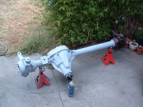

About 6 months ago I scored a $174 (tax & disposal fee included) HP 60 from a non-disclosed location in the greater Los Angeles area. This find sparked a few "may as wells" as you will see.
Before I go too far, heres what I had:

After finding the front 60 I started getting parts:
Spool (for rear, Detroit from rear goes up front)
Yukon 35sp shafts
Long Joints
Slugs
and all the rest of the junk it takes to rebuild a front end.
Its so beautiful!
