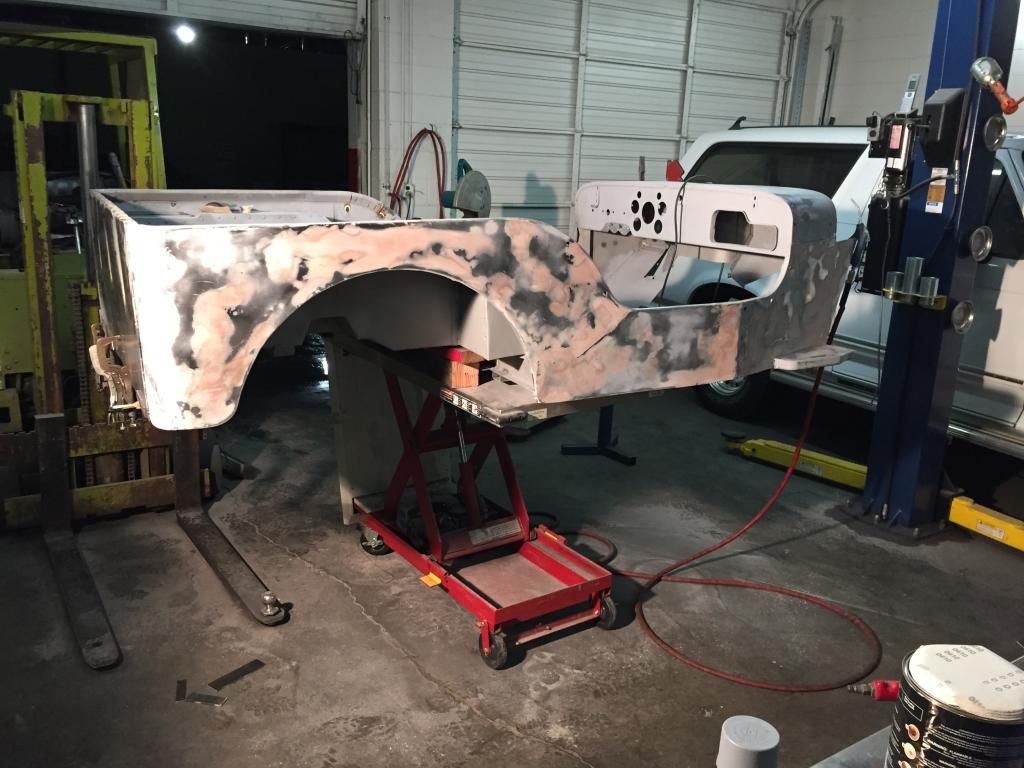

So I haven't updated the thread in awhile and figured I would post some updates on the flatfender build!
The front of the tub was stretched 4" and the side step was extended and reinforced as well.
The tub finished up as of today and ready to go onto the chassis.

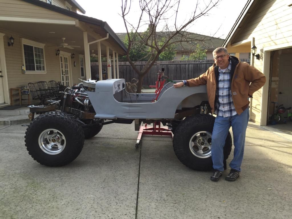

I ordered up a JD2 Model 32 manual tube bender last week along with a 1.75" die set (5.5-180). The shipping cost on the thing was Insane! Luckily the Pirate4x4 discount offset the shipping cost :D Once that is delivered I'll get to work on building a stand for the bender and then set to work on the roll cage. (Still deciding on what design to go with)
My dad recently picked up a 1945 GPW after enjoying working on mine with me. Between building my cage and the one we are going to build for his flatty, along with some rock sliders and other various future projects we decided to split the cost and invest in a bender.
After towing home my dad's GPW we realized it is ironically suited to him. He was on the Army pistol team back in the day and shot with a Colt .45...His weimaraner pup's name is "Colt" and he now owns a 45 GPW which came with the custom license plate, "myold45"
How he bought it:
He snagged the 45 for a screaming deal considering everything that had been put into it..Chevy 350 that hasn't seen a single mile since it was built and dropped in, same story for the 700R4 transmission..and Atlas II Transfer case..as well as the Front and rear Dana 44's..and the 35"s, and pretty much every other part on it! Has original data plates, glove box, frame, 50 cal mount and a lot of other parts with Ford F scripts riddling the thing. The downside was the body, bondo everywhere covering up holes from rust.
We tore into it the night he got it home and stripped it down to its frame.
Since then the 45 has had parts welded on that were screwed on (the jeep was pretty much just mocked together..for ex. the transmission was bolted up but with no torque converter :shaking: shocks were added, steering buttoned up, the body sandblasted
patched with bondo
fixed up nicely for an offroad rig, driveshafts ordered and installed..He is setting his completion deadline for Moab EJS..
Picture as of this morning:

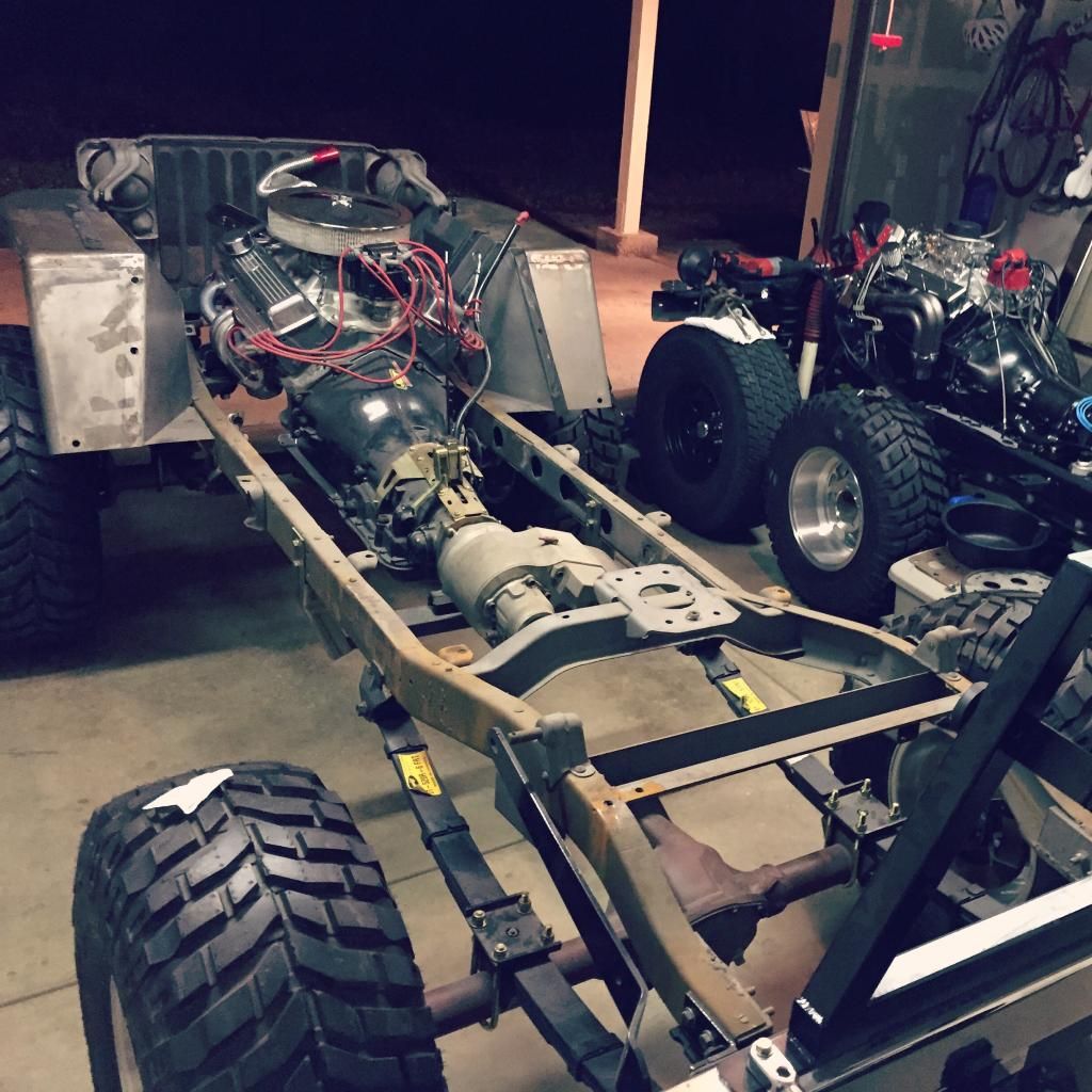

Set the tub on the frame. It's mocked up with PVC pipe cut to 1.5" as that is the body lift I will be running. Any ideas on what to use for the actual body lift? I have thought about ordering up a tj body lift kit from somewhere like Morris 4x4, but if there is a cheaper option, or one that will allow me to cut the pucks to variable sizes, I'm all ears!
The only place I had to trim the transmission tunnel for clearance was for the transfer case.
How much room between the firewall and distributer is generally recommended? There is currently about 1" of room.

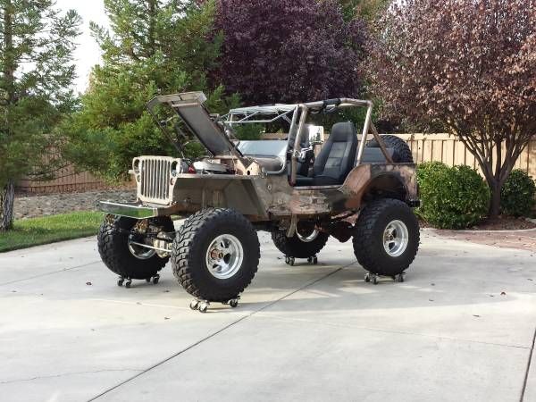

Discussion Starter #56
Got a little bored this evening while working on adding some subframe support to the tub and decided to throw the windshield onto the GPW so I could start envisioning what roll cage I want to put on her.
