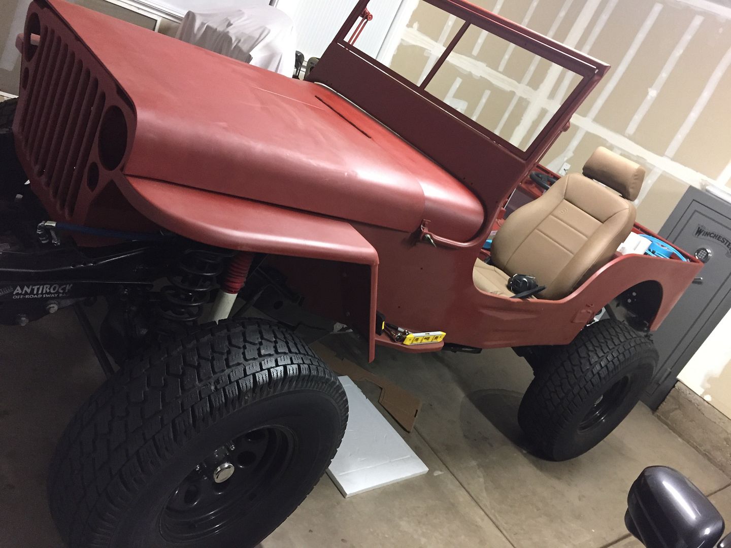

Well school is out for the summer which means it's time to let my mind think about something other than school FINALLY:D I only have my Fall semester left to finish before I'll graduate with my Bachelors of Sciences.
Things that have been done to the build this past week:
I got a subframe for the floor of the tub built and welded together. I made it out of some simple rectangular tubing, and the floor of the tub no longer pops and flexes when weight is placed on it. This tubing also provided for a mounting location onto the frame for a third body mount located back towards the front of the rear tires.
I cut off the old TJ frame body mounts and welded them up in their new locations (In the pictures below you can see the front two mounts have been cut off and moved about 5 in. rearwards)
I also took a trip to the local J&G Jeep junkyard and picked up some TJ mounting hardware rather than cutting up boat rollers or hockey pucks. By welding in the TJ body mounts just slightly higher they were able to give me the 1.25" Body lift that I was needing.
*The body mounting hardware was just coated in surface rust (which made them cheaper to buy) but to anyone out there looking for a rust removal trick:
Soak the item in some apple cider vinegar overnight and the next morning the rust will be gone and you'll have a brand new part. I've also used a mix of molasses and water..With this you can fill up a huge rubbermaid container with the mixture and soak larger rusted items.
The front fenders were then cut to fit my frame. This took way longer than I had expected. I was going at them with a cutoff-wheel. In the end they fit, but while I was sitting their hacking at them I was dreaming of better tools for the job.
The hood fitment is way off so I'll need to drill out the mounting holes to make them wider so I can slide the thing more towards the passenger side.

I wasn't satisfied with the look of the family style cage on my rig so I've decided to go with a classic look and build a simple cage. I think it will fit the jeep and look much better in the end.
