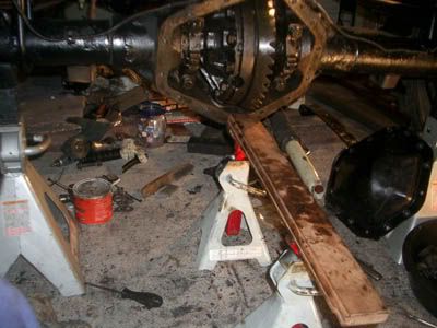

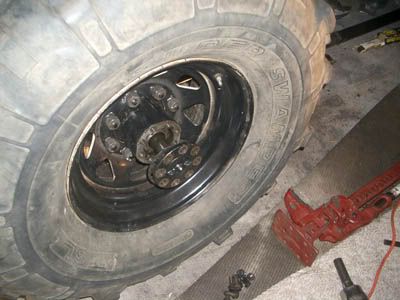

1- Start by lifting your rig on jackstands, if the axle is still installed. This will give you better access, and help with testing the install later. Start draining fluid of the dif, removing the cover ( I left the top bolts slightly tightened so the fluid would drop slowly, and not make a mess). While the fluid drains, remove the 8 bolts in each hub which hold the axle shafts. slide the shafts out about 10 inches in each side. Now remove cover fully.

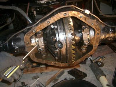

2- The 14 bolt is held by a turning nut colar, which has holes, one on each side of the carrier. I scratched a line on the colar and housing, which would provide me the original position of the carrier. The colar nut with holes pushes against the bearing races.
3- The bearing races are held by bearing support brackets. The supports have two large bolts (one top and one bottom), and a small bolt in the center with a wire prong. The prongs hold the colar nut, so that it will not move up or down. Start by removing the center small bolt, with the prong on both sides. I recommend keeping things aside and organized when removing parts, so they do not get mixed up.
4- Remove the bolts holding the bearing support brackets. Start by the bottom, and renmove the top ones last. Keep track of which side is which,a nd what side goes up or down.

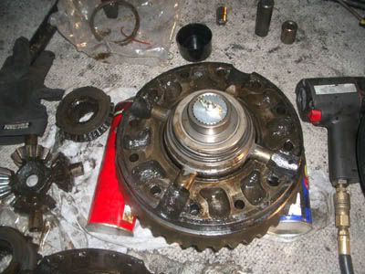

7- Ok, while the dripping is going on, now yu have the carrier on the ground. This is the easy part. Remove the bolts holding the carrier to the gears, (12). I recommend using a impact gun, since those suckers are tight. Before removing the bolts, I recommend marking the gear and carrier side. This way you will mount them in the correct position. Inside the carrier, on the gear and removed side there is a small arrow imprinted indicating were they should be joined, but I am not sure if it is the same for all 14 bolts.
8- Remove the spider gears, they will come out easy by hand. Make sure you remove ALL the thin washers\shim looking things. attached to the spider gears. Clean up the inside, there wil be plenty of old brownie style gunk. Now install the Detroit in position. IMPORTANT do not remove the holding pin and screw that holds the locker together until you have the carrier back together. put the carrier back together and tighten the 12 bolts. The carrier should now be ready to install. After tightening the 12 bolts, make sure you remove the pin and wingnut that hold the Detroit together. It is important to do this only after the carrier is together, otherwise the Detroit will come apart. Put the bearing races on (a small amount of bearing grease will help them stay put and not slide out when you push the carrier back in.
