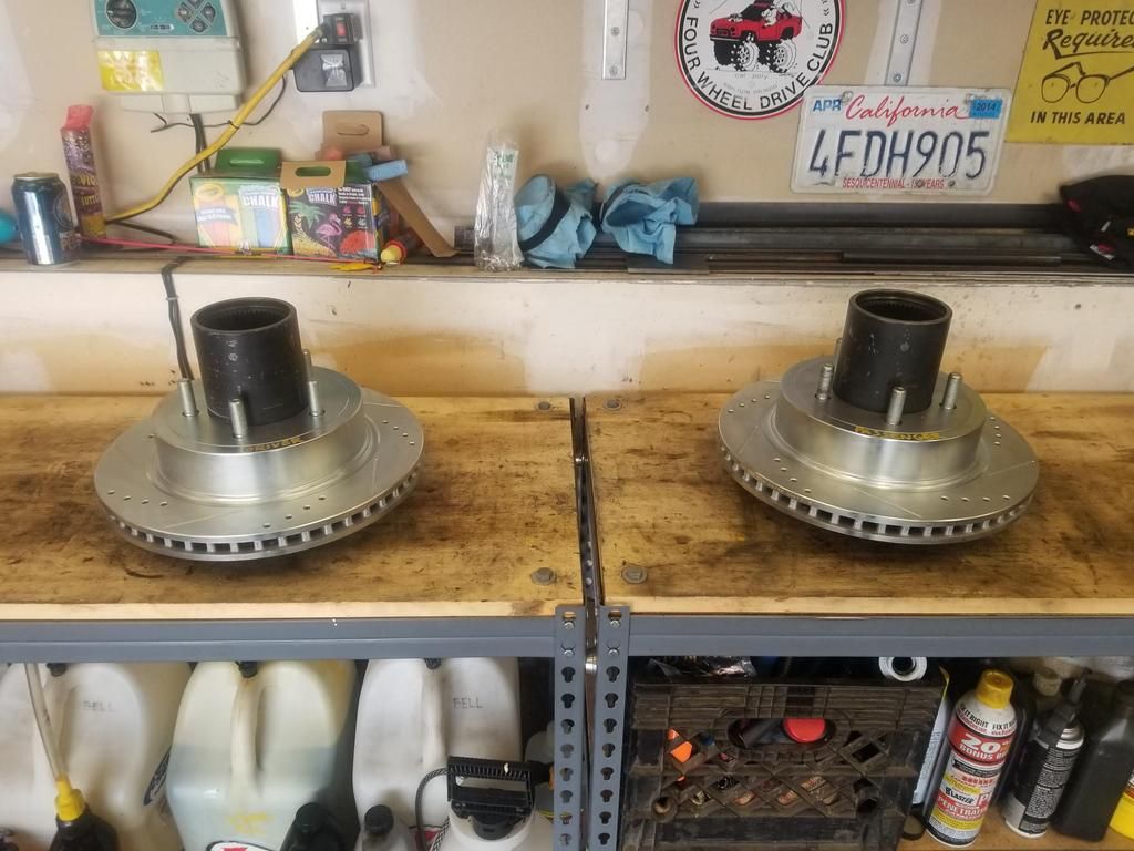

Rotors:
I found a local machine shop to bore out the center holes. Finn Mototech in Broomfield if you're interested.
Great group over there -- they're down for the cause.
Did the fronts & rears.
Rear rotors are off of a 78 F-150 (right) 11.75"
Fronts are an 06 SRT-10 pickup (left) 13.7"
Got the rear put back together. Ended up using EBC Yellowstuff Pads. Hopefully their shit is still legit despite Brexit :flipoff2:
New Napa semi-loaded calipers too. 88 Grand Waggy (same as all 1/2-ton single piston)
Wheel Studs:
With the rotor fitting over the hub v/s on the back I needed another wheel stud. The knurl needed to be different.
Note how the old stud is made to accommodate a rotor pressed on. New stud has knurl all the way to the head.
Left: 88 F-350 front stud. 9/16" (not sure on part number)
Right: Dorman 610-188.1 --- 9/16" 81 Chevy Somethingoranother
I added some spacers behind the studs so the wheel lugs set properly. All in all pretty straightforward w/a little research & mockup.
Finally justified the space my press takes up in the garage :smokin:
