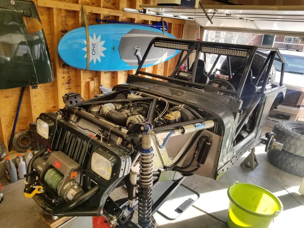

Radiator replacement is complete. New upper & lower hoses. Was able to transfer on my old shroud onto the new Ron Davis 26x16 unit.
Rivets + ultra grey = no aluminum welding required. :flipoff2:
(last time I sat in my dining room was Thanksgiving 2016)
Like a glove.
I finally upgraded my windshield-washer hose bleed lines to -4 AN Push Lok. Was on borrowed time there for sure. The lines run from the top of the radiator & from to the "steam ports" to a remote surge tank. (you'll notice my new rad does not have a cap)
Last on my list for Moab prep is finishing up the brakes. After this season I'd like to do more homework on the correct master cylinder for my application. I think even with the upgrade in rotor diameter & pads there will be add'l room for improvement.

I idled my rig in the garage to bleed out the cooling system.
With the removed thermostat I was surprised how quickly the system came up to temperature. Fans kick on at 190F (I think) and manage temperature with ease. When running hard I'm hopeful it work out.
I've heard stories from others saying the run all day without fans turning on... not sure how that is possible.
Jury is out on how this will perform in real life. Will follow up after the trip.
