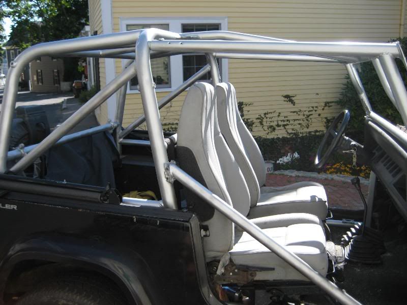

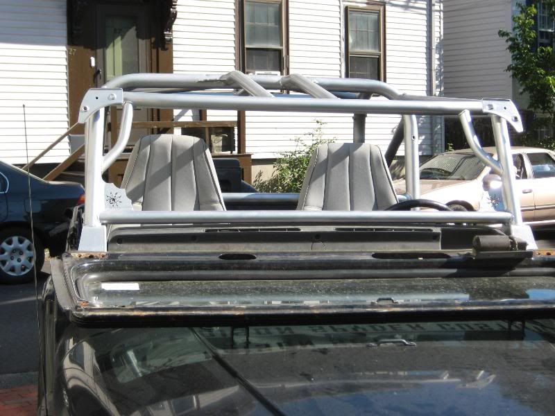

Let the building process begin, didn't want to put this in the hardcore section...well because I bought some prefabbed stuff and didnt want to get flamed...
Cage I fabbed along with the trail portion of PSC:
Running 5.38's with ARB in the Front and Detriot in the Rear
Rear BTF relocation Bumper:

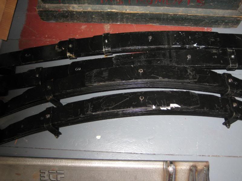

RE 1.5 Springs with XJ rear springs:

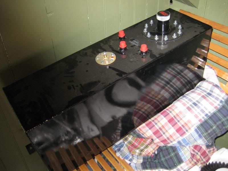

RCI Fuel cell:

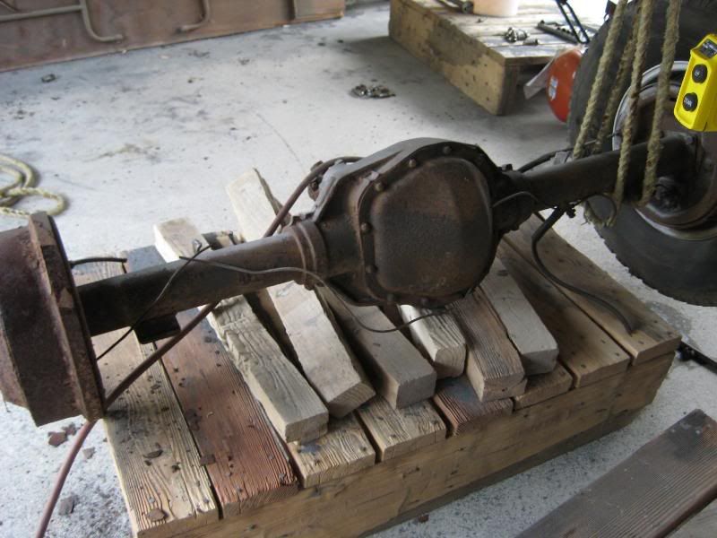

Rear DANA 60:

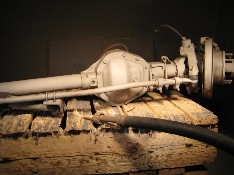

Front DANA 60:
Build should be happening in the next couple weekends...have all the parts except tires, shocks, driveshafts and brakelines...Just picked up a DANA 300 so I'm waiting for Duffy's flip kit to come in...

Yea after I ordered it and talked to people I realize that I should have indeed used the detroit in the front and the arb in the back. The axle is in deed a 60. It came out of a 88' F350, front and rear 60's

Well after looking at some pictures...it looks like you guys are right and I'm wrong...this sucks...looks like I will put the detroit in the front after all, send the ARB with compressor and gears back and order the right ones for 10.25. Hopefully PORC will take the exchange they are used only problem is that I ordered them in June. Will Ubolts for the dana 60, work on the 10.25???
No, really, the axle is in deed a 10.25, sterling 10.25 to be exact, yes its 35spline and a perfectly strong axle and it did come stock in a '88 f350, but it is no way shape or form a d60.....I'm not trying to be an ass, but you need to get it corrected before you can't return your gears and locker. I'm trying to save you time and money. Look at the cover on the front of your 60, now look at the cover on your rear axle.....they are nothing alike, thats because they are not the same manufacture. D44, D50, D60, D70, D80 they all look similar cause they are all Dana, your rear axle is not a Dana.
Unless you just attatched the wrong picture:flipoff2:

I know your not being an ass, thanks for pointing it out tho!!! I realized it a post above yours, didn't know if you saw it. But I just emailed PORC to make the exchange, and i WILL be putting the detriot up front and the ARB in the back! Thanks for the notice...I 'll shoot some more photos when I get more done.
