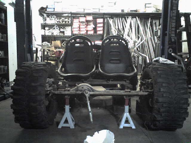

i had a set of 31" boggers, freebie, i wanted to keep it small and low and narrow... i need it to fit sideways on my trailer that i tow my camper and buggy on... so i se my eyes on a set of sami axles, offset diffs and narrow... then i got a set of late 90's dodge 1500 wheels that i machined to larger hub bore, they were 16s that i needed for my tires... i used a 93 civic for a drivetrain, 1.6L vtec sohc and an automatic...

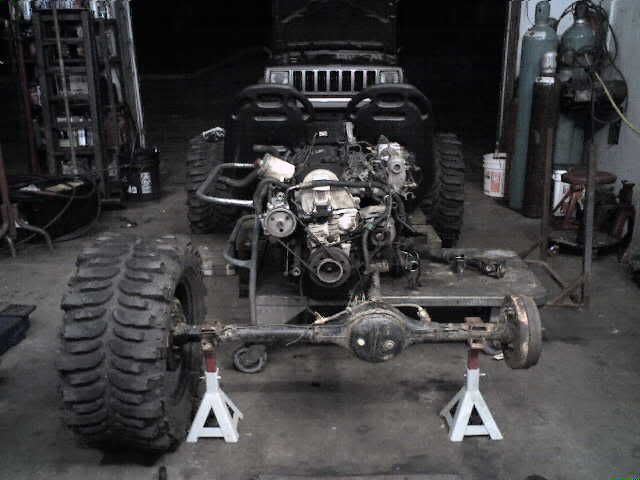

this is what i started w/, a honda drivetrain, a set of sami axles and some boggers...

82" WB, pontential cage height of 62"... the cab is tight as frog pussy, but i think it is going to be fine... the master cyl will mount in the rear, so nothing will need a "firewall"... these are at full stuff...

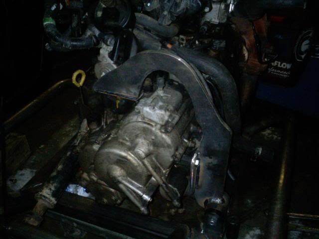

update... i got some work done this weekend, spencer and i set the engine up on the "subframe" and mounted the first piece of tube, which is the hardest by far... i did realize that i will need a wider set of axles, which are from a newer models... made one of the tranmission/ driveshaft adapters, the motor mounts are done...
this is the mounts
flanges...

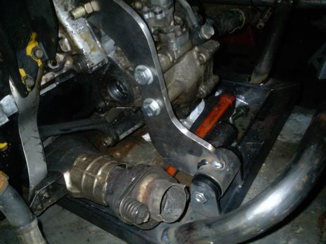

so it seems as though i have come to a screeching halt... visually that is... i am trying to work out details now... anyways... heres the progress...
rear motor mount...

very kool! :beer::lmao: I want one now. how wide is it outside of tire to out side of tire?

not that it matters, but is that rear axle bent? or is it the picture...?
#29 ·
i guess it is the picture, you did make me look, but if you are refering to the very first pics, i dont have those axles any more... they were like fj43 or something like that, basically pre 86 sami stuff.... they were WAY smaller if you can imagine anything being smaller than sami axles....
