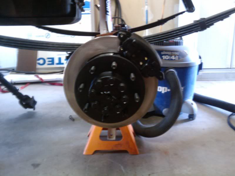

#15 ·
When i was doing all my research i found that the 2 wheel drive ford spring's are 57" long and 2.500 inches wide. The 4x4 spring's are the same length and 3 inches wide. I went to pick-n-pull and found a near perfect ( thanx cash for clunker's) 1992 2x ford extra cab. So i grabbed the spring's and headed for summit for some new bushing's. They only had gay red and we all know about summits special order's and i wanted to get it done sometime this year. So gay red it was. I tore the whole leaf apart and cleaned and painted everything. I also installed new shackle bushing's too. I left the overload's on so i could see how high it sat before i removed them.
Sketched out a front spring mount and talked connect into burning them out for me at torchmate (big thank you mike) then once i had everything together i need to figure how far forward i wanted to move the front spring mount so i mocked up the spring's and figured it would be around 8 inches forward from the stock front hanger.........and yes my youngest helped and yes he wore saftey glass' in this pic he was messing around
i wanted to french the mounts into the frame but there is just to much crap in that area. Since it is a standard cab fram and i have slider's i would have had to cut one tube of the slider out and move the rear cab mount... Screw that

#23 ·
SO I WELDED THEM IN AND HERE BE THE FINAL PRODUCT LOL . I DID TAKE IT OUT WITH THE BED CUT AND NOW THE TIRE WILL TRAVEL ABOVE THE HEIGHT OF THE BED ROUGHLY 6 INCHES . THE WAGONEER SPRINGS IN THE FRONT AND THE F-150 SPRINGS IN THE REAR FEEL VERY STABLE AND FLEX GREAT OH AND CHECK IT ......NEW TO ME TIRES :smokin:
NOW THAT ALL THAT IS FINISHED I SCORED A DANA 60 FRONT FOR $350.00 SO I TORE INTO THAT AND NARROWED IT 3 INCHES ON THE LONG SIDE ( TO MATCH MY CHASSIS LONG SIDE ) I ALSO SCORED A DANA 70U WITH A LOCKER THAT WILL GO IN THE REAR. I HAPPEN TO HAVE A SET OF 39.5 TSL ON SOME BART WHEELS THAT I WILL INSTALL WHEN I DO THE SWAP
