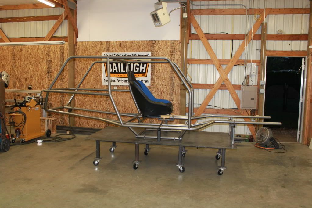

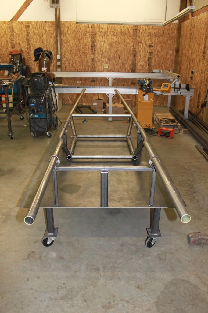

It all started getting the chassis all jigged up
