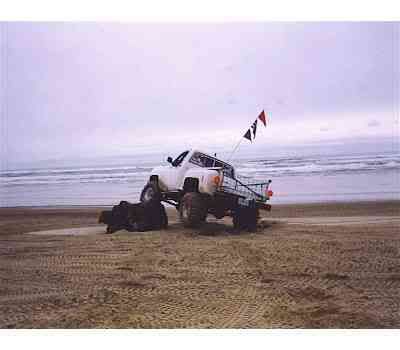

the best it looked when still street legal, didnt have a digital camera back then so pics were few.

The turning point that got me in the direction I am at now would be the tube bed. I got tired of smashing in the fender sides so I built this. It was actually 1 1/4" schedule 40 poop pipe, but worked great. Low budget was the only way I could afford to wheel.
I ran around with that bed all the way up till this year. At this point it was still a daily driver I used to get to work. Shortly after I also built an inside cage out of the same poop pipe. No pics of of that, I will have to dig thru old piles of photos.

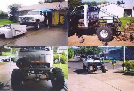

I pulled the rock sliders for more ground clearance and before I knew about boat siding a cab I just cut the rockers off and welded some square tubing at the door opening, also cut the rusted corners out and reinforced the corners. These work good, actually still running the cab like that, simple but effective.
Never being able to leave anything alone I decide to tube the front end with the intent of leaving it street legal, I didnt own a tow rig or trailer so I didnt have any choice. So out of more poop pipe I run the cage thru the front firewall and built a pipe core support. That only lasted until I went to put sheet metal on, cause the first thing I did was narrow the front end. So a tow rig was now in order. Anyway fast forward again thru some more boring tech this is where I was at.
