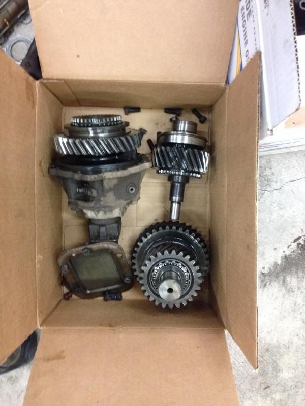

Putting my 205 back together, I have around .003 of endplay on the idler gear. Should i tighten it up or run it? (new bearings, i could take out a .0045 shim and have a bit of preload?, or sand down the thicker shim for 0 endplay)
spec is .000 to .002
I want to run it because i think? i read somewhere that no preload is better on a 205 idler:confused:
Discussion starter · #39 · (Edited)
I would run it at least at 0 endplay... Where else do you have opposed tappered roller bearings and run them with no preload or worse slop? With preload there is no question that the bearings will run hotter. (So do pinions, and hubs when the bearings are brand new)
I am taking a shot in the wind here, but I bet they wrote the instructions (with endplay), because it would be difficult if not impossible to meassure preload any other way then by hand... just my opinion...
Also as the cones and races wear they will create there own endplay so if you start tight it will wind up loose, start loose and it will end up sloppy...
I also spoke with two different shops about the idler one said 0 endplay, the other said 0 or either a little preload.
I put mine in with 1 thou of preload, spinning by hand mine will turn about 180 before it comes to a stop (but it does take a little bit of effort to turn its not loose)....
