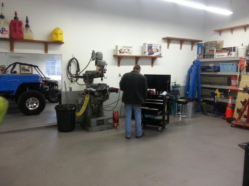

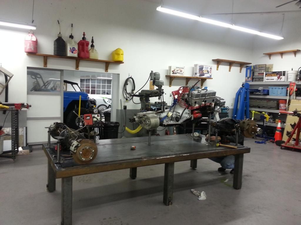

well this is an interesting start to a "shop???" buggy build?
anyway, carry on :flipoff2:
oh, and you should have had that chassis table blanchard ground.
Interesting indeed. I think we are on the right track though.
