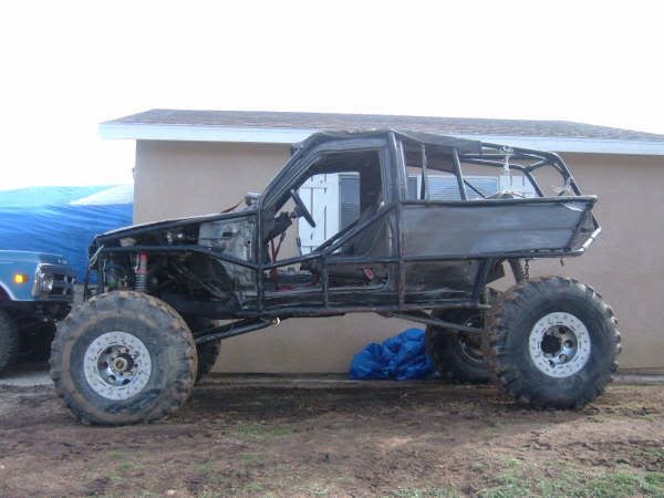

So the plan is to redo the entire cage, lower the ride height, flat belly and go thru the rig head to toe and make sure everything else is good. I am also going with
44" TSL's.
Here are some pics when I first got it
I really did not like the back section.

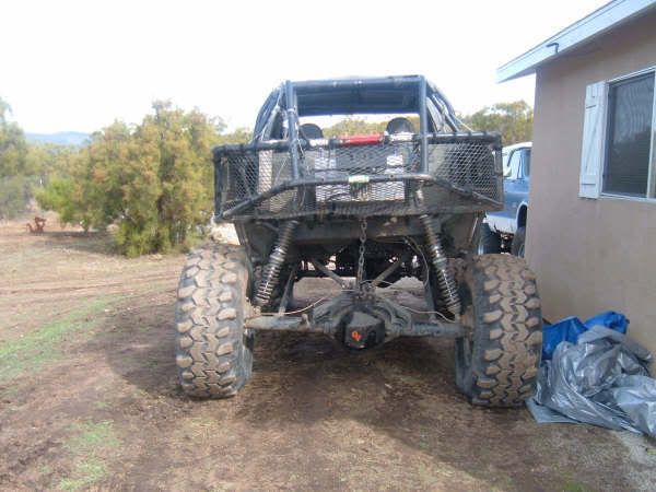

We started working on it last weekend. Didnt get a whole lot done. We are still working on the design of the new cage and what we are going to do with the rest of the truck. We did manage to change the tires out. 39.5" gone 44" installed. We also removed the rear of the rig. While we were cutting the back off we noticed that some of the welds holding the rear shocks was ripping out and the cross member was cracked all the way around on both sides. Here is a few pics from what we have started.
The problems
Since the crossmenber was pretty tore up we cut it out not to beefy of material. That will get fixed with some thicker material.
Here are a few shots of the new shoes and the rear of the cage removed.
Odered all the steel for it yesterday cage will be 1.75" .120 wall DOM. Should be delivered on Friday this week or Monday of the following. Going to finish removing the cage and setting a new ride height next weekend after TDS.
